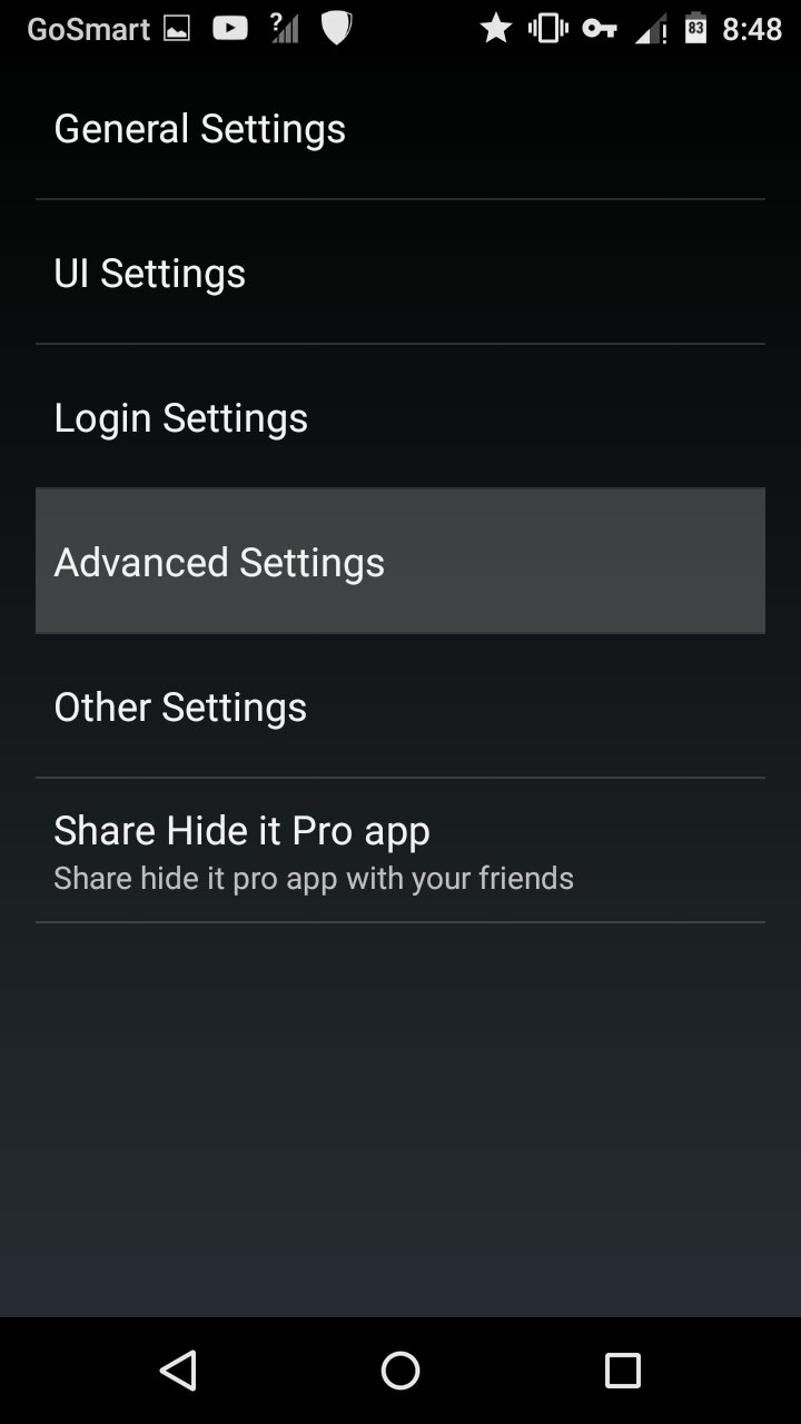

Go into your Hide It Pro app and check your vault location. That should give you some direction to where the programdata file is which is where your hidden files will be.. UNLESS you've changed your vault location. It's in your phone so you should be able to search for the file.
If you are having trouble searching for it on your phone, then try connecting it to your computer to conduct a search
