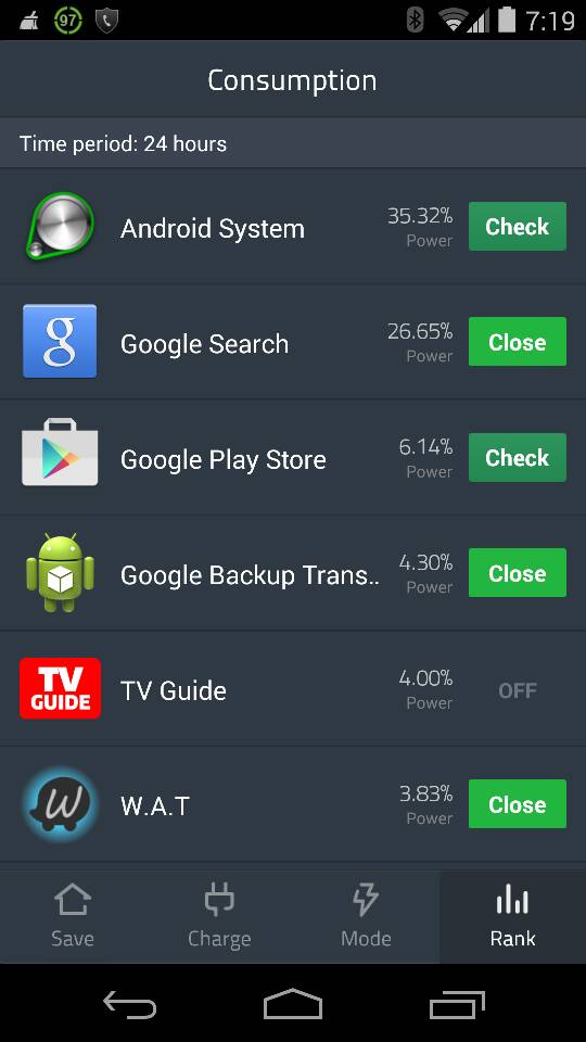

On a side note, I've noticed the app "Google Search" draining a ton of power. Whenever it's active, it drains about 5% every single hour with no other apps on. I have the Battery Doctor app installed and it keeps complaining about its wastefulness.. anyone else see to have this issue?

I assume you mean per hour?
The amount google seach uses probably depends on what your location settings are etc.
Here's a screenshot of battery doctor with Google search using 26% of my battery in the last 24hr. Keep in mind I use Bing as the default search on my phone and barely touch Google.. I also ended up killing it countless times so the proportion would've been even higher if I left it alone.
Turn off hotword detection?

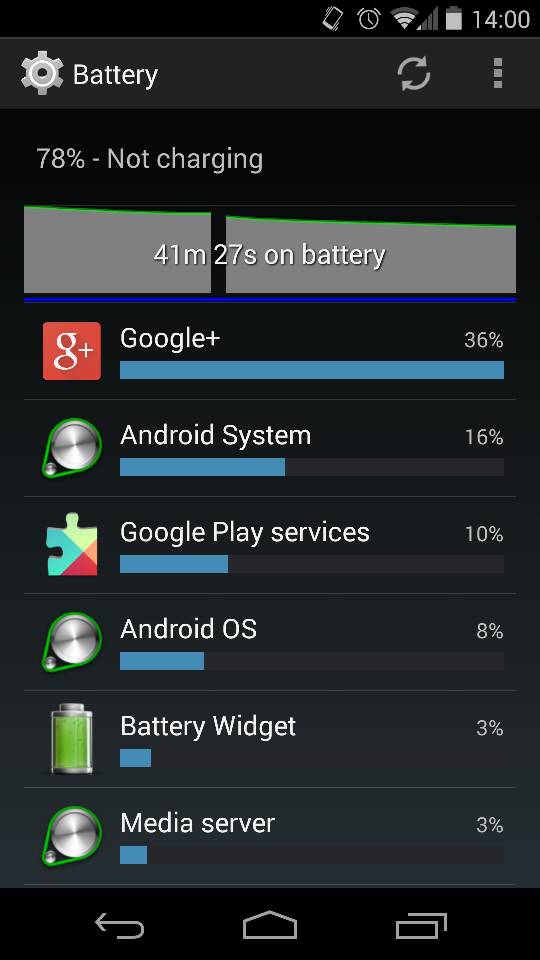

In the last few days my battery has become so poor the phone is getting to the point of being worthless.
I unplugged at 8am this morning, and at the time of writing this (10.40am GMT) I'm down to 33% with almost no usage! Yesterday was similar, I plugged it in at around 5.30pm and by 9.45pm I was down to 6% with no usage at all.
Looking at the battery info screen, Google+ was using 25% yesterday and today's drain is down to Android OS using 77%.

Do you have Google Now on? I found it a terrible battery drain. I turned it off and have great battery life. Also, I have location reporting off as well. Maps, GPS, etc still work fine with it turned off.
I do have Now turned on, but I always have. It is only in the last couple of days that battery consumption has got this fast. I've also not changed any of the other settings around location - GPS is off, but location reporting is on.
Everything is identical to how it was a week ago, only now the battery is depleting much faster
It may not help, but try a simulated battery pull. Hold the power button, ignoring the pop up menu, until the unit spontaneously shuts down and reboots. That will often straighten out power issues the same way a physical battery pull can.
Thanks. Tried that and now 41 mins later I don't think it has made any difference. I charged to 100% and this is what has happened since I unplugged it....
