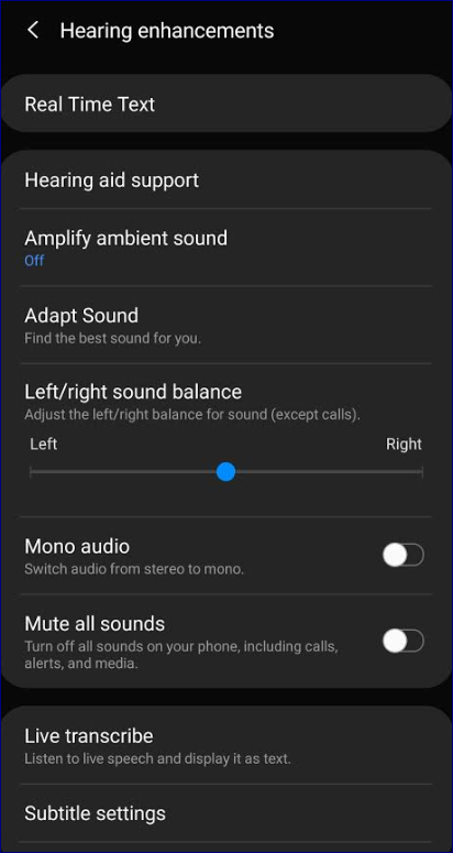

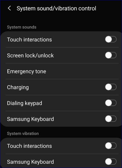

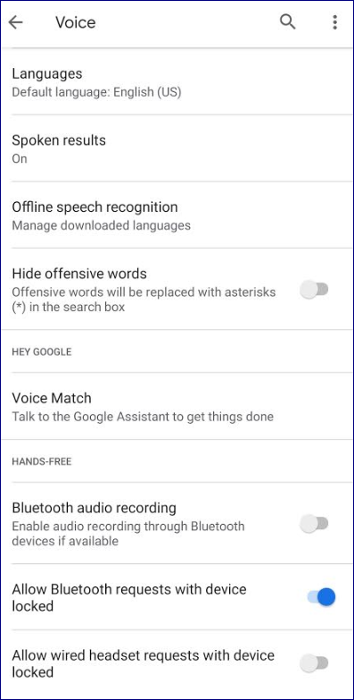

Hi:
Thanks for the responses.
I was using the Samsung Keyboard on my S-10 with "Google voice typing automatic, enabled". After reading Rob's post, I downloaded "Gboard" and set it as the default instead of Samsung. I went into phone settings and disabled Google Voice typing and then went into Gboard and enabled "Use voice typing". Unfortunately, I get the same annoying loud beep feedback sound when I press the microphone button.
I went into as many settings as I could find on phone and in keyboard apps and made sure that anything that would cause this annoying feedback was off. It happens no matter what keyboard I use so it must be something in the phone settings?
I can't believe I'm the only one who has this issue.:thinking:
Thanks for anymore suggestions!

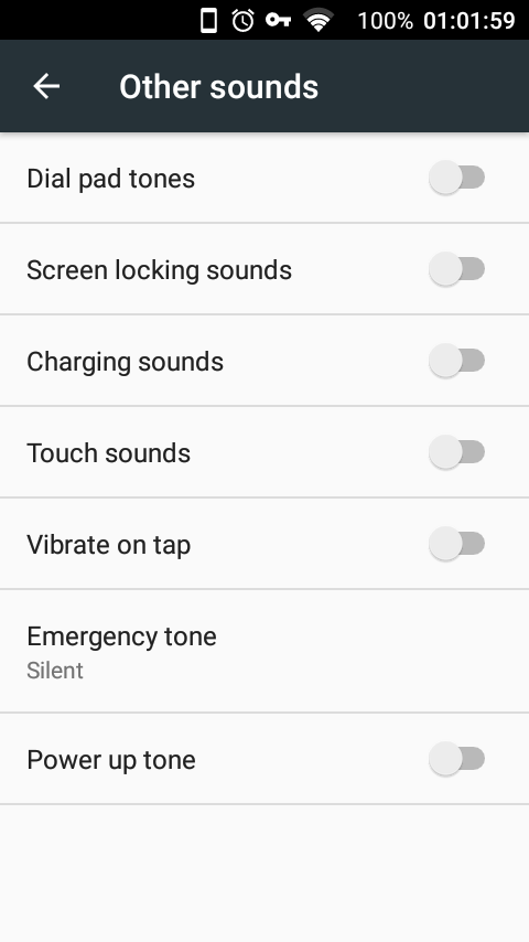

Thanks for the input. I don't have an "other sounds" or anything close to it on the S-10. I watched the video but don't have anything close to an assist and/or voice input selection under Apps.
