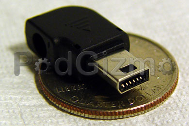

Above is "EMU" connecter (EMU stands for Enhanced Mini USB) this connector is pretty much the same mini-b USB connector except EMU also has an audio channel.
In the above image:
In the above image:
