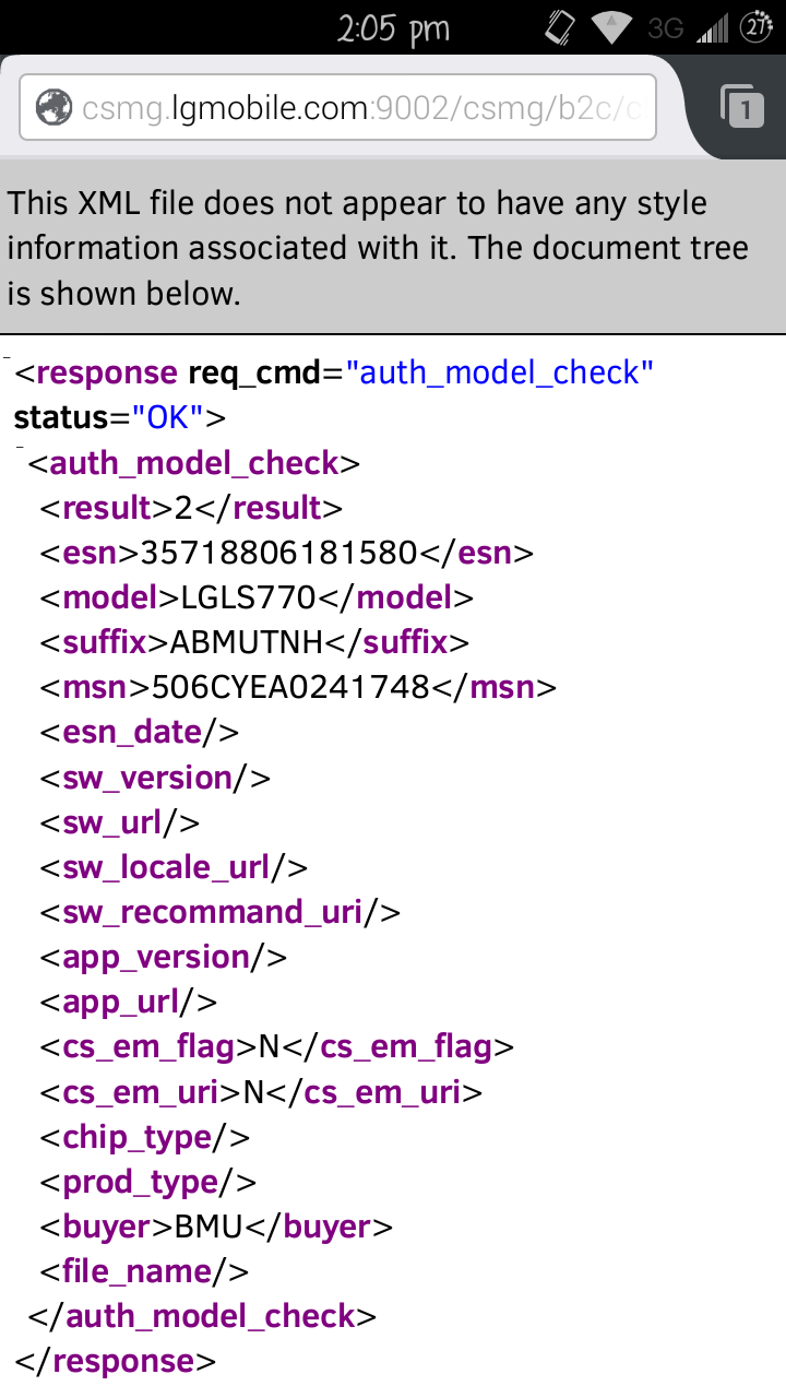

I need a KDZ for boost mobile so that I can either reset my system.img on 5.0.1 or a KDZ for 5.1 to update straight to that.
This is what I got on Mobile it might work on computer tho
Okay so you have to use the HEX IMEI with CDMA
did you even try? cuz if Metro and Tmobile have the KDZ already pretty sure Boost is there as well
like i said before read and follow instruction.
http://csmg.lgmobile.com:9002/csmg/b2c/client/auth_model_check2.jsp?esn="YOURIMEIHERE"
take the "YOURIMEIHERE" including " and type your IMEI there i don't know anyone with boost mobile so i can ask them to check
I've been trying it for days dude. I'm not a moron.
Boost got the update before T-Mobile and Metro but we haven't gotten a KDZ yet.
I still don't see a kdz file for our boost variant :/
