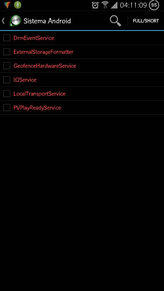

Ok but where is in disable services ?
Thanks
As I said in my earlier thread, which you quoted:
Additionally, I found a Knox service running that needs to be disabled - TimaService (within Android System, AKA com.android.server).
IOW, just install the app and search for Android System under the "System" tab. They are in alphabetic order, so it shouldn't be difficult. Once you find it, press on the title; it will reveal another screen with all the running services for that selection. Pressing FULL/SHORT will toggle between the "friendly" name and the full name as found under /system. I'd include a screen-shot, but I no longer own that phone.
Ok thanks,
As you can see on my screenshot in my last answer, there isn't anymore timaservice in the android system.
What module do you use in xposed ?
Thanks
