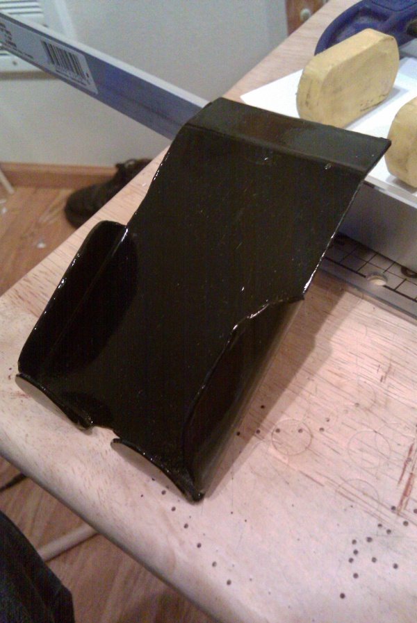

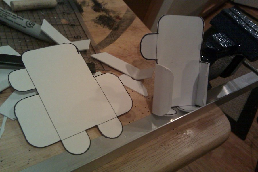

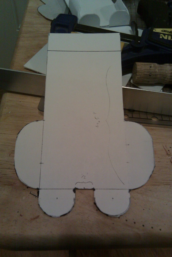

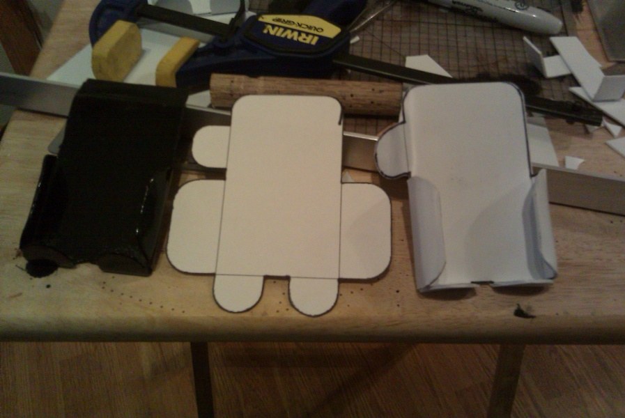

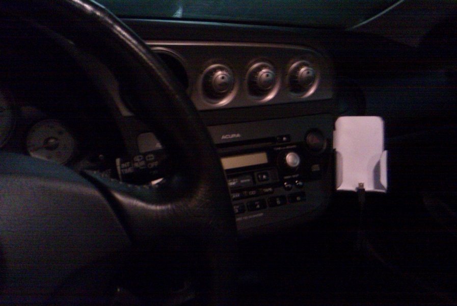

I had considered plastic dip, but I've only used the rubber stuff for screwdriver handles etc., and wasn't sure how thick the stuff ends up being. Also, the TPU is slightly grippy, so glossy enamel/lacquer finishes will allow it to slide in and out easily, whereas a rubberized finish i would expect to make it difficult. If I could coat it in something like the material from the back of the phone, or Seidio's material they use for the innocase, that would be perfect, however my local hobby shop doesn't have that kind of stuff and I have no idea where to find it.

I used your plans to make my own. I added a vent holder to the back so it's next to my radio so I can hook it up to it.
Did you mount a cable to the bottom of yours? I'm trying to figure out how to permanently mount a cable. I also folded up the ends of the feet so it won't slide out.
I don't like vent mounts, especially since Styrene does NOT have a high melting/forming point, and if the heat is on I could easily see it just drooping into a mess.
I didn't figure out a way to mount the mini usb plug to the bottom, I don't have the tools to measure exactly where it'd need to be, or the tools to accurately mount it there, so I just have space for it to plug in.
The feet on mine DO come out at 90 degrees, but I didn't form them around a dowel as the sides already keep the depth stable, plus getting a dowel in there would've been a major pain with the sides already done, or made the sides a major pain with the feet already done.
Actually considering using model paints to color it like the android guy. Already have lime green for the airbrush from the Kawasaki Ninja model kit I made of my bike, but I'm unsure how well the paint bends. May have to drop by hobby shop and talk to the guy about it.
Wouldn't exactly match the interior, but as the female friend I mentioned it to said, "Aww, that'd be so CUTE!"
I live in St. Louis so in the summer it gets really hot here...I think it would melt then too. :D
Hehe, I live in Washington, so the heater gets turned on QUITE hot here. Some months yet before I have to worry about the exterior temperature causing problems.
I am going to order up a sheet or two of kydex and try it out of that. Much higher melting point and quite durable. May even wrap my phone in saran wrap and make a mold, then do a nice close form. Now if only I knew somewhere local to get kydex and what to expect pricewise. I don't do well with waiting, as you guys can probably tell. As a tester/prototype the styrene is holding up quite well so far. Haven't done any SERIOUS spirited driving, but I'm quite happy except for the heat issue. May line interior with craft foam so it's a slightly more snug fit, but all in all I'm quite happy with it.
