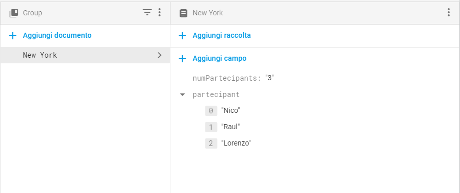

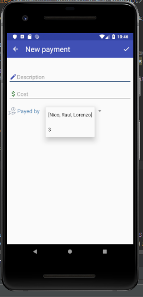

The problem is that in this way, I get all the field of the document(you can see in the picture below) and even the partecipantsArray is bad formatting, because the name are all in a row, how you can see in the spinner screenshot.
There is a way to get only the array "partecipant" from the document and save it into another array?

So this block of code
Code:
for(Object item : task.getResult().getData().values()) {
      partecipantsArrayList.add(String.valueOf(String.valueOf(item).split(",")));
      Log.v("vettore", String.valueOf(partecipantsArrayList));
Is adding the entire string of values, separated by ','. You want to iterate over the list of values
Code:
  String[] values = String.valueOf(String.valueOf(item).split(","));
  for (String value in values) {
    partecipantsArrayList.add(value);
(code is completely off the top of my head, uncompiled, and untested. I'll leave that to you)

Thanks for the fast answer...
I just tried your code and..it works! Thank you so much!

I need to remove the last index(I think I can pass to the spinner the partecipantsArraylist minus the last index). Could you tell me how to do that? Then, how you can see in the screenshot, I need to remove the first "[" in the first name and the "]" in the last name, so in the penultimate position. Is it possible?

Just solved it!
I modified the code this way:
String[] values = String.valueOf(item).replace("[", "").replace("]", "").split(",");
Now it works!
