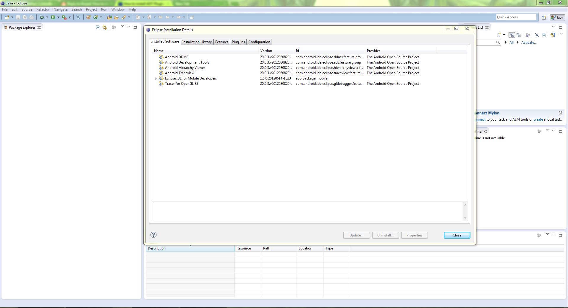

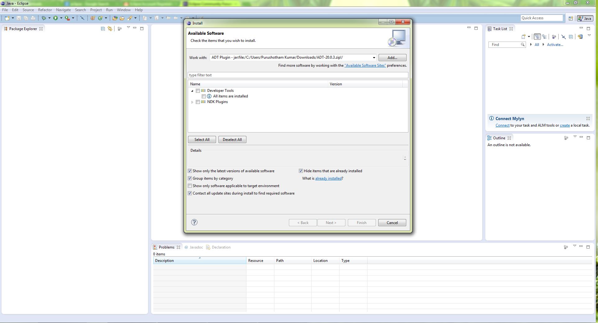

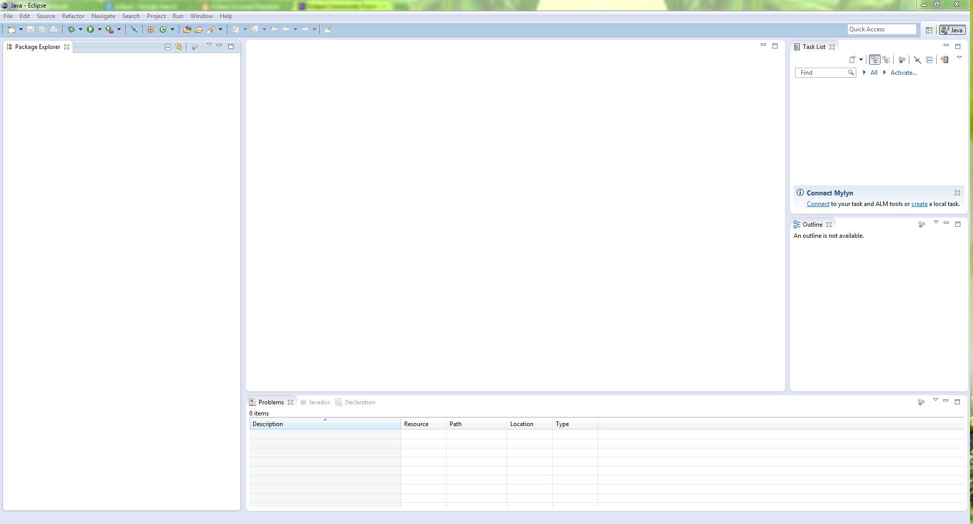

I downloaded every package of eclipse and tried to install android plugin (ADT Plugin). Always it install successfully but failed to create android projects as the plugin doesn't enable in my system.

Here i am adding screenshots after installation. it is installed success full but can't find anywhere

Click on
help->about eclipse->installation details
this will show what you have installed. Take a shot and post here.
