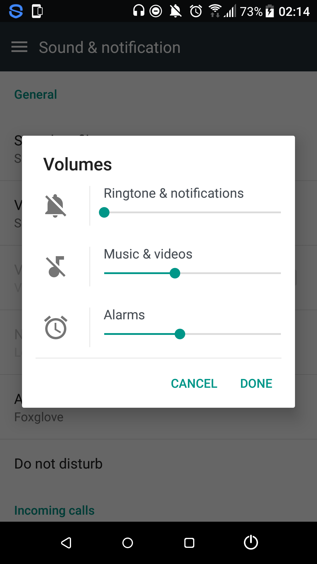

When I go to "settings - sound and notification - sounds" and look at the tree sliders, the media one has a strike through.

I've never had an m9 but on my M8 and 10 I can go to Settings>Sounds & notifications>Volumes and turn down Ringtones & notifications and Alarms but keep music blasting.
Hi, thanks for the comment. That icon is muted and does not change if I move the slider. If I change the level of the same from from the drop down option the slider slides back by itself. If I press the volume buttons nothing happens.
That was not happening with Android 6. Started few days ago with the latest update.
Edit: If instead of choosing a sound profile I manually adjust the sliders the top one turns into "sound off and vibrate" not mute. If I click on the vibrate icon it turns into dnd and that automatically brings the media bar to mute.

Okay. I think I figured it out. First in Sounds & notifications turn of vibrate, then do the slider thing.
Thank you. I actually tried that earlier today. I turn the profile to normal. Go to setting - tick off vibration. Go to the sliders and move the top slider to the left. As soon as I slide it to where the zero would be the phone vibrates and the icon switches to vibrate. When I click done and look at the settings window the vibrate option that I just ticked off is now grayed out. Notifications and phone is now in vibrate mode.
Another click on the top slider turns it to mute which causes the middle slider to mute as well.
