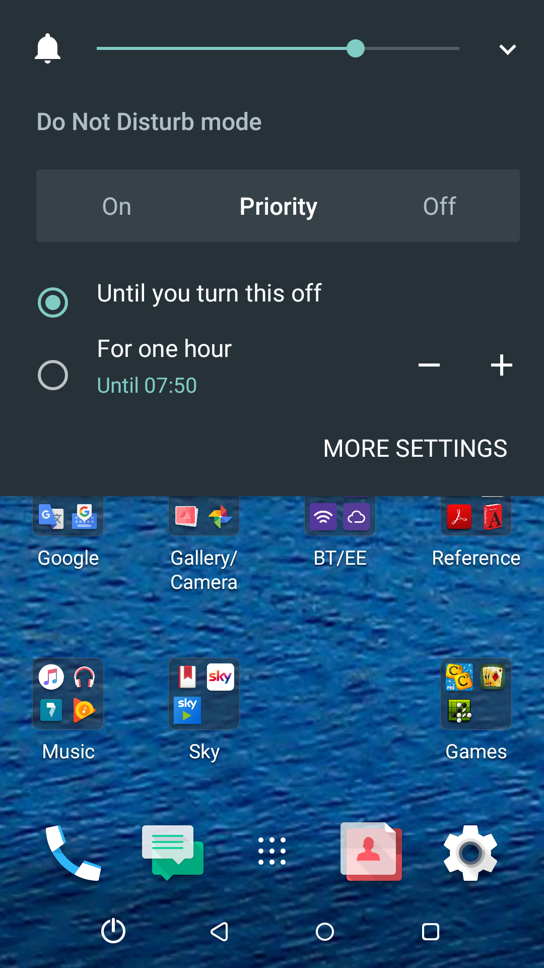

On my M9 (Android 7), full DND does kill media audio, but if I select Priority mode, media audio is still active and it can be set so that all other sound output is silenced.
I also have a DND switch on my 'Quick Settings' so it can be accessed by a menu pull down and one tap to switch on, one tap to switch off.

On my M9 a single tap on either Volume Up or Volume Down brings a DND switching option on screen which is as convenient as the 'Quick menu' option.
Do you not have this option either?
