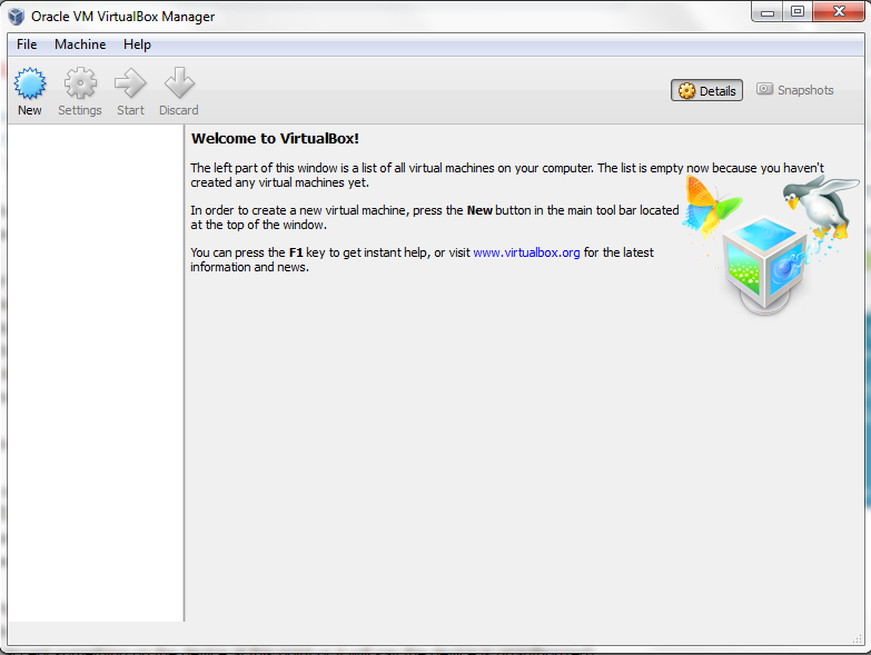

After you download the virtualbox.exe , go ahead and install it, i left all the settings alone.

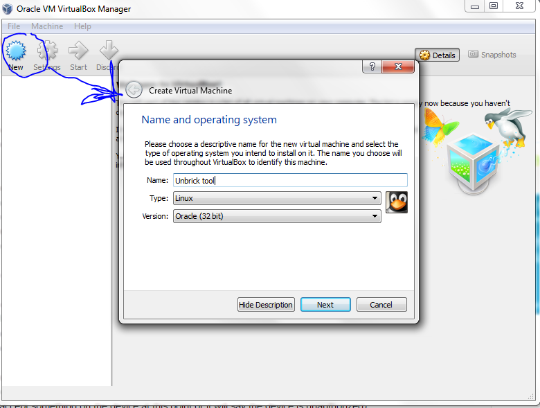

This is what it should look like after you install it. Next you will want to click new.
I named the machine Unbrick tool for the sake of this guide. Choose linux as the top option and oracle 32 as the bottom. Again after setting those 2 options i left all the other settings alone for setting this up so just keep clicking next and you should be fine. Note- This is what worked for me. You should wind up with it looking like this now.

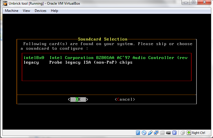

Now click start.You will get an option screen, just choose the top one by pressing enter. On the computer i was using i got a popup for sound, it is not needed for this but for the programs sake just choose either one.

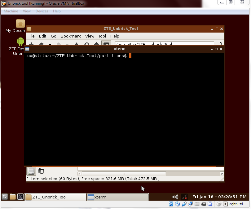

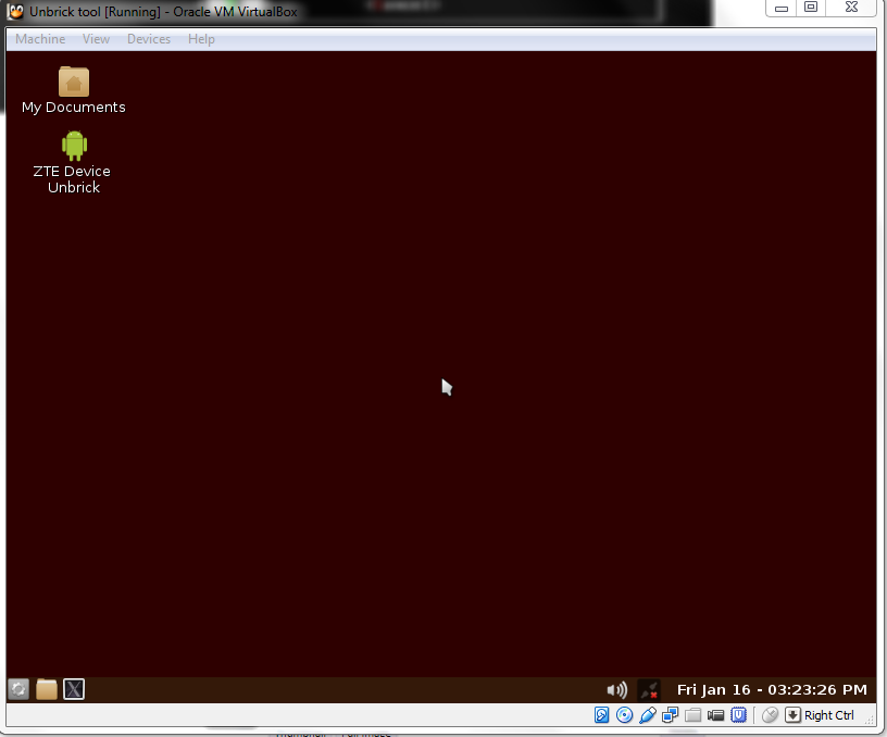

Your virtual machine should now be booted and look like this.
Click open the folder with the lable my documents, go to the folder in that called ZTE unbrick tool, inside that folder right click the partions folder and left click the open in terminal.
Type the following in the terminal:
adb reboot bootloader (Here you may have to right click on the little usb icon and selected the zte option)
