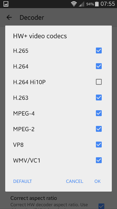

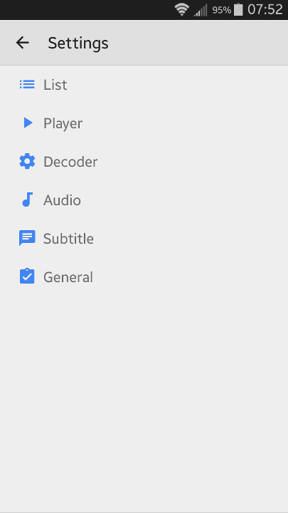

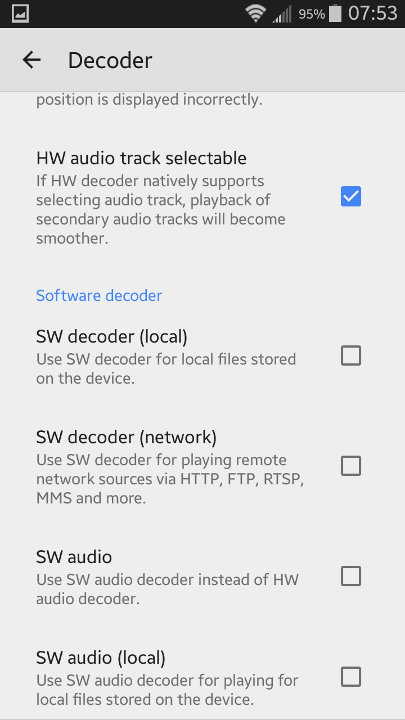

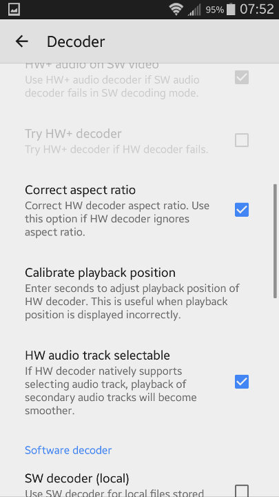

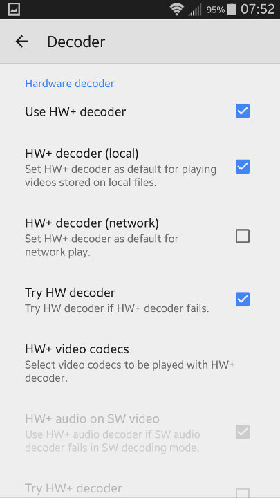

I'm puzzled about the sparse number of options in your Settings menu. Is your MX Player app current? The last update was in this past January.
https://play.google.com/store/apps/details?id=com.mxtech.videoplayer.pro&hl=en
These screen captures show some of the Decoder options that I see in my MX Player.
View attachment 106211 View attachment 106212 View attachment 106213 View attachment 106214 View attachment 106215
Right... Silly me, I was trying to find these options while playing something. I've found them now.
I've set it to HW+ and setting as in your images. H265 was unticked and so I've ticked it.
