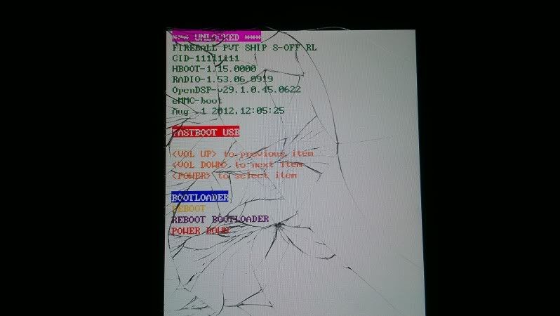

before:

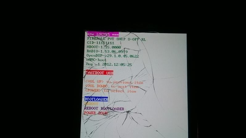

after:
sure,i could have easily faked the above photos,but i dint.

before:
after:
