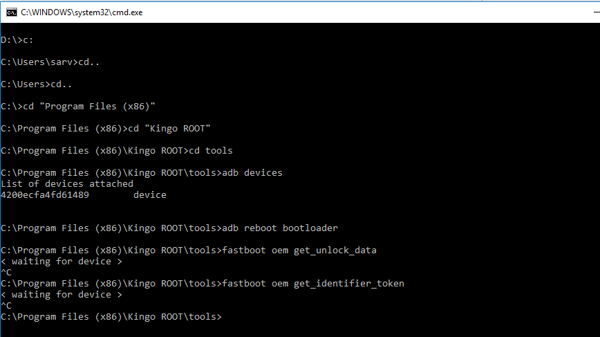

I m trying using as commands and trying lot of search more. but not find exact solutions . for rooting the device android 7.0 . so please use command for the waiiting message in below screen shot.
. but developer options OEM enable bootloder.
"Waiting for device" suggests to me that your phone isn't responding to the command.
I presume you checked whether it was communicating with fastboot first ("fastboot devices" should return the serial number of the phone - if that doesn't work no other fastboot command will). If it does respond correctly to that command then I suspect that your phone doesn't support bootloader unlocking, or else you need to do something else to enable it.

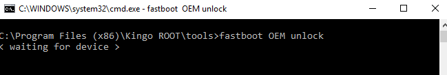

Please be show all the message but device is not root and waiting error message show . please help me
OK, you used "adb devices" rather than "fastboot devices", so didn't confirm that fastboot is working. But the fact that it says "waiting for device" rather than "no device found" makes me think that it probably is communicating with fastboot. Would still be good to confirm, using e.g. "fastboot devices" or "fastboot getvar all".
But if fastboot is working and you are getting no response that may well mean that your bootloader just doesn't accept those commands. In which case there's nothing you can do to make it accept them.
