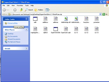

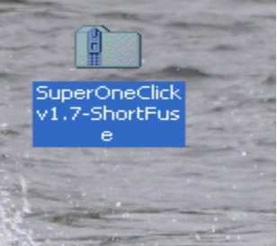

1. Download superoneclick v1.7 from MEGAUPLOAD - The leading online storage and file delivery service
2. Extract the files to a location,
attachment.php
attachment.php
attachment.php

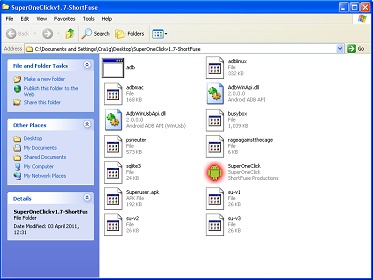

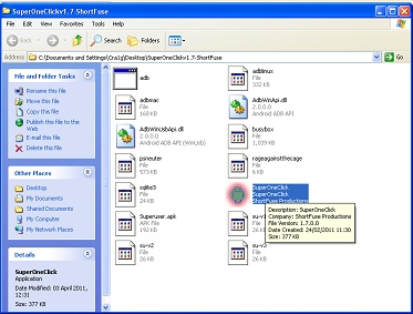

3. Open the folder containing the extracted files,
attachment.php
attachment.php

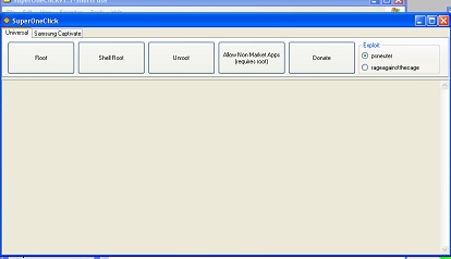

4. Open SuperOneClick,
attachment.php

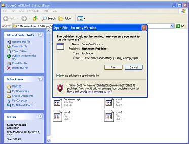

If you get a security warning when opening SuperOneClick, just press "Run"
attachment.php
attachment.php

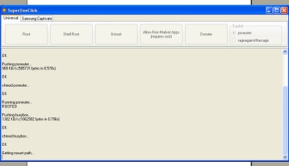

5. Hit the "Root" Button
attachment.php
attachment.php
6. You should now have superuser access and the superuser application icon on your app drawer.

Running psneuter...
ROOTED
Pushing busybox...
1071 KB/s (1062992 bytes in 0.969s)
OK
chmod busybox...
OK
Getting mount path...
rootfs / rootfs rw 0 0
FAILED
mine keeps failing as above :( any advice?
Never mind I fixed it :D
