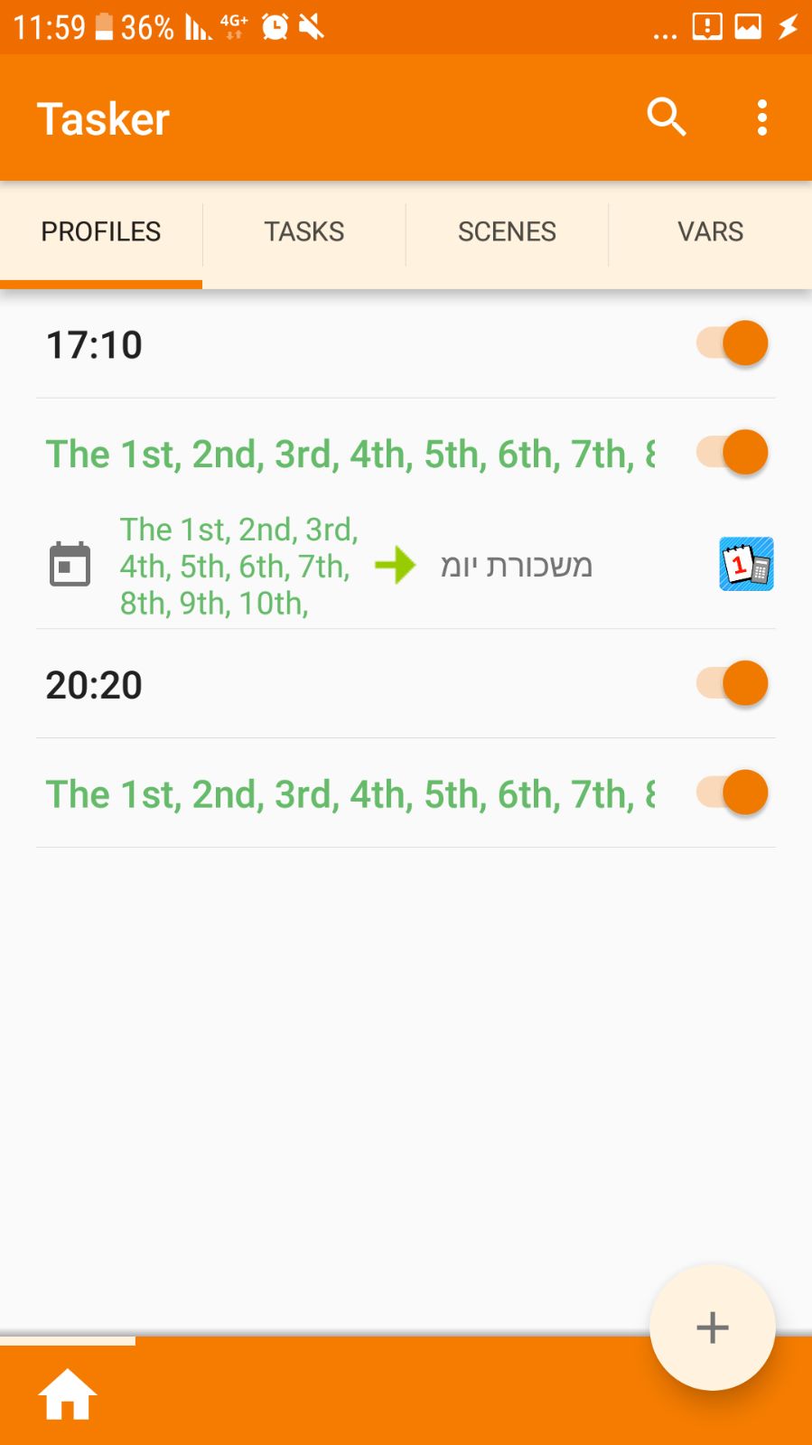

how to stop previous app in tasker?
haima123
tell me please if am runing to apps for exmpale
the first app at 1500
and second one is at 1700
how can i cancel the opreation of the first app in the interval between the 2 apps
beacuse i am a begginer at this and dont know how to use the varbiles in tasker
can you tell me how to do it like in exmpale file i attached here

hey tom thanks but i dont know how to write those lines of commands
can u tell me how 2 do it like its written in the file i attached
This attachemtn does not show anything other than four profiles and one task name in an alphabet that I do not use.
I posted two Profile/Tasks that control the start and stop of a sample app … in this case Calculator.
What is it that is not clear?
