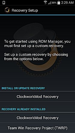

I can't get into Recovery Mode though. Pressing Vol Up-Power-Home just boots the phone normally. I installed ROM Manager, and the first screen it brings up is:
Is it saying that I already have both CWM and TWRP installed? Or is it expecting me to know what is or isn't installed and to pick the right option?

I used to use ROM manager, but gave up on it after it stopped working properly it would not flash things properly with Philz (a clockwork mod variant) recovery and this led to many a bootloop. I just go to recovery nowadays with the three button method. It is asking which one you have in your screen shot, it expects you to know.
Keep trying to get to recovery, it is difficult to judge releasing the three keys at exactly the right time, I fail a good three times out of four and have to start again. Trust me, you have some sort of recovery on your device be it stock, TWRP or a variation of CWM.
To be sure you can always just flash the one of your choice using Odin, then you got can tell ROM manager and access it from there. I might try ROM manager again now I'm using TWRP recovery to see if it works once more.

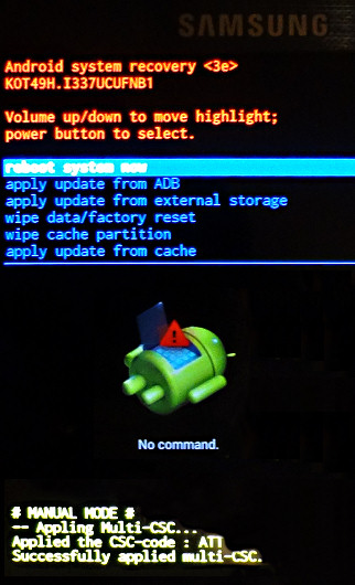

I never did get into the Recovery Mode with the Vol Up-Power-Home buttons no matter when I timed it. But I did use ROM Manager by backing out of that screen that wanted to do installations and then selecting "Reboot into Recovery". That gave me this screen (contents moved closer together just to keep file size smaller).
So I take it there's no custom recovery installed and I still need to install either CWM or TWRP, correct?

Yes you just have stock recovery. As for flashing a custom recovery with ROM manager I wouldn't know, I've always used Odin.
