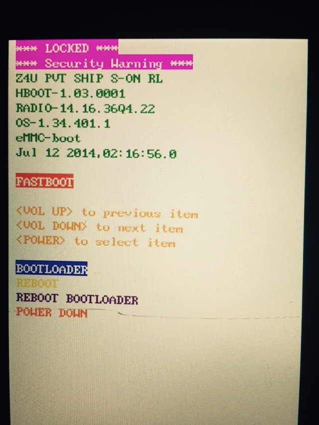

I've ran into a pretty big problem with a HTC Desire 500.
After a couple of small problems and bugs, i've tried a factory reset, the phone worked for a couple of hours, but then it froze. Now it will only start in fastboot mode.
I don't really know what to do from here - if i press recovery, i get the green HTC logo and nothing happens, even after 15 minutes.
The phone is from Vodafone, so i guess it's locked. Is there any way to fix the phone or is it bricked?
I've lost all hope, i've been trying for days but nothing seems to bring it to life.

No, i can't unlock the bootloader, it's still locked. I got the code to unlock by mail from htcdev, but when i do the command in cmd on the computer, the image with unlock appears on the phone, but nothing happens when selecting "Yes". If i select "No", the phone restarts.

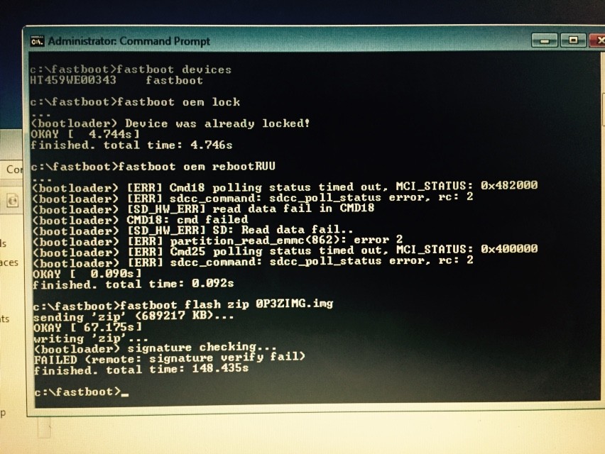

'All other supported models' i think it's called. It's the last option from the list, because the Desire 500 isn't listed.

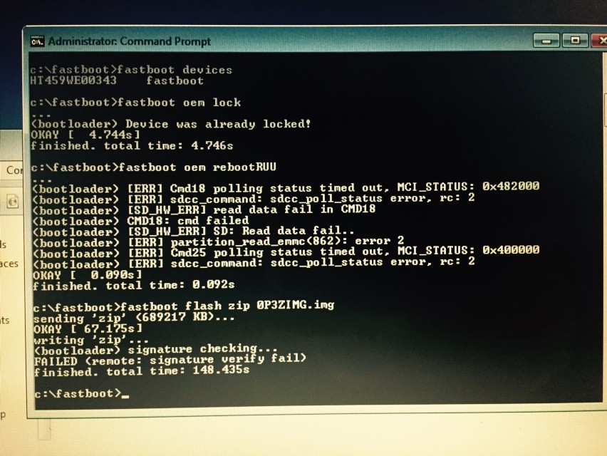

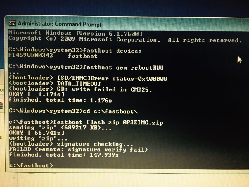

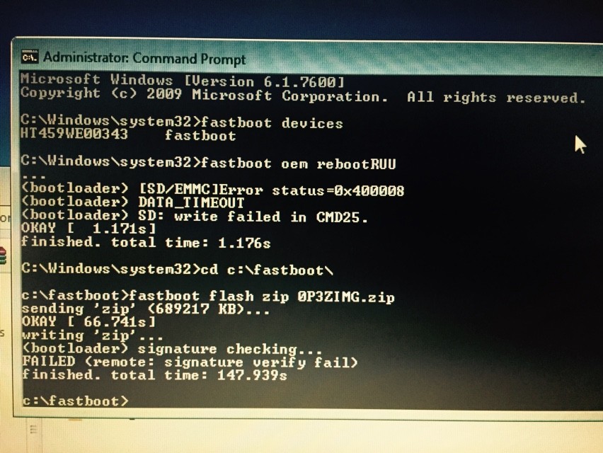

I've tried loading the downloaded .zip from your link through fastboot, but i get multiple errors.
After two attempts, these are the results:

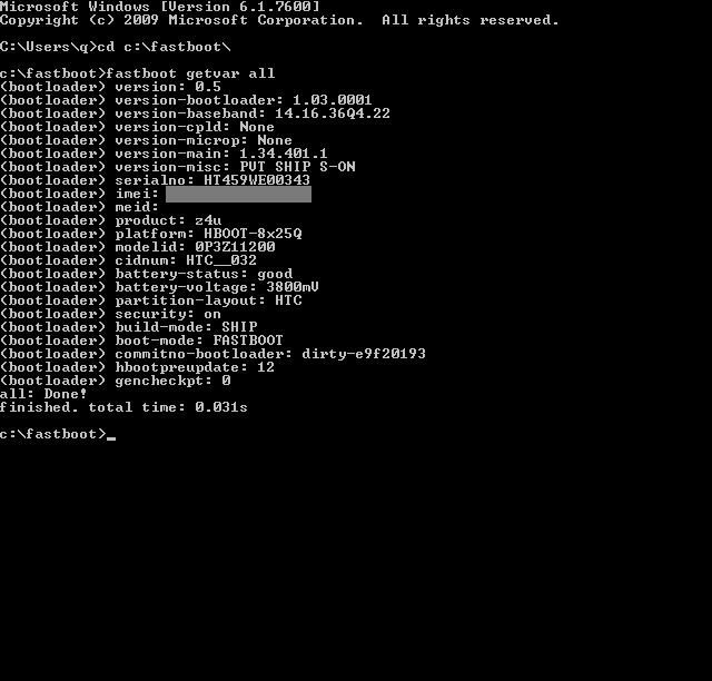

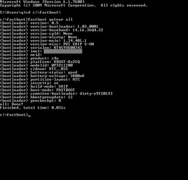

Also, i've attached the fastboot getvar all.
From what i found on other threads, the emmc may be faulty. So, hardware problem..
That's what it looks like. Well i tried. If it's under warranty return it. If not well there are tons of newer devices that look nice.
