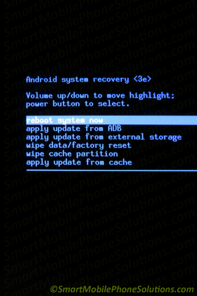

It worked in my case:
1)Turn off phone
2) Hold Volume down + power button until htc logo apears
3) choose recovery (Navigate with volume buttons choose with power button)
4) Red triangle apears now press (button mash) volume up + power quickly untill screen changes to something like in attached photo
choose wipe data/factory reset (Navigate with volume buttons choose with power button)
