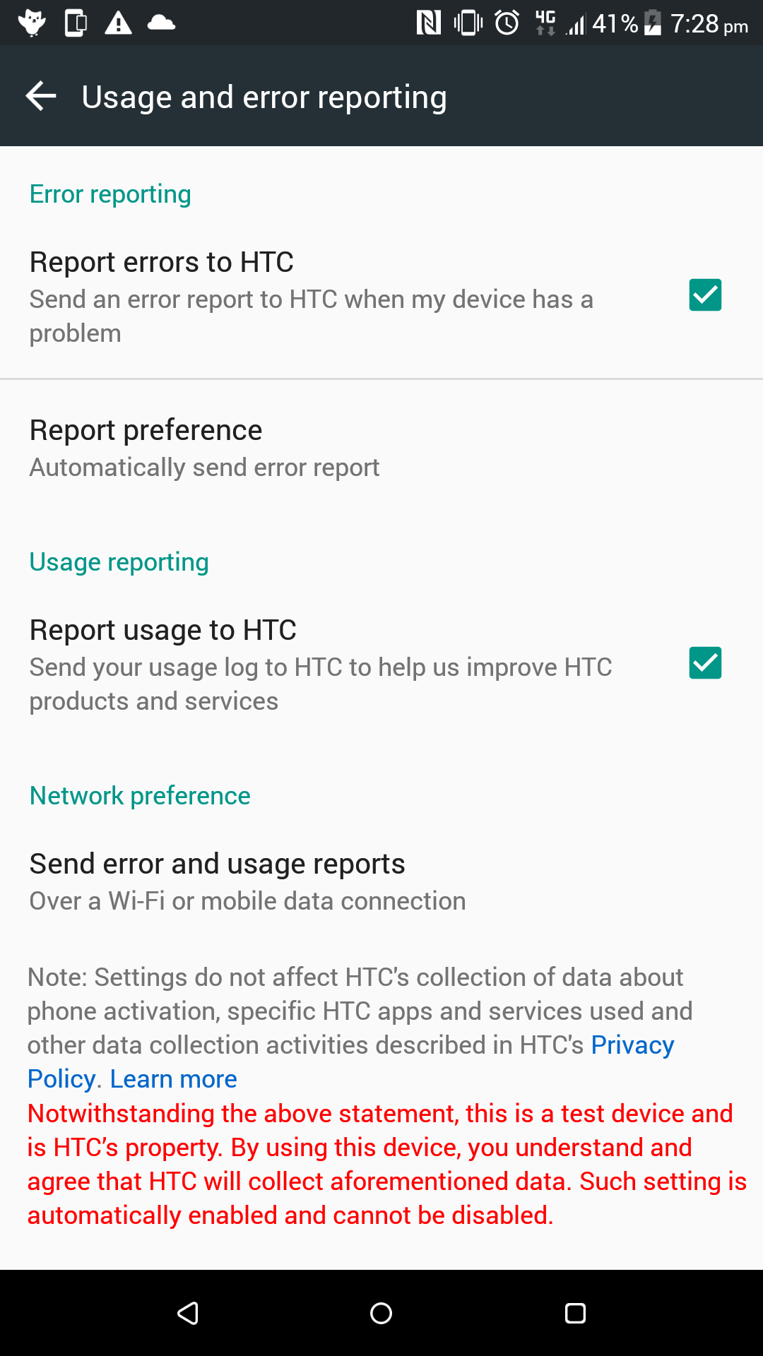

I felt it was a little too good to be true as well. I've attached a screenshot with some of the information regarding the device.
I installed all of my apps at once. I'll give safe mode a try again - my problem is this isn't a super frequent issue - twice a day would be extremely rare, probably once every 2 days on average. A full day without it dying wouldn't be unusual even with full normal usage. I'd expect a day of safe mode to be fine purely because I can't open anything or really use it - which seems to be the trigger. Still, I'll set it up tomorrow and repeatedly unlock it to see if I can :)

Oh yeah, I have seen that message before. It is not what I was picturing at all, but I have seen that. I think it was on an HTC 10. That message might appear on all devices in the newest versions of HTC Sense?
(side thought; Could it maybe also signify if the phone is locked vs unlocked, rooted vs non-rooted, refurbished,
or flashed and de-branded for your international travels - if your phone was flashed with the incorrect firmware it could cause lots of weird stuff to happen)

Oh yeah, I have seen that message before....That message might appear on all devices in the newest versions of HTC Sense?
There's a much longer version when you first setup the phone. It is quite explicit about it being a test unit and not for normal distribution, so I don't think it would be a common feature.
(side thought; Could it maybe also signify if the phone is locked vs unlocked.....if your phone was flashed with the incorrect firmware it could cause lots of weird stuff to happen)
Hmm, that IS food for thought. I wonder if it may be running non standard firmware. The box still had the factory seal on it and I never specified I was going abroad, so I'm not sure they retailer could have done much. Would it be potentially worthwhile flashing it?
It is difficult to describe this in a coherent way .... Just trying to provide an example of sorts.
