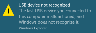

i typed fastboot devices nothing happens, i typed adb devices it just says list of devices attached and nothing below that. Also this appears when i go into fastboot
So ADB isn't recognising it. Do you have USB debugging enabled, and is it booted into Android? ADB won't recognise it unless both of those conditions are met.
