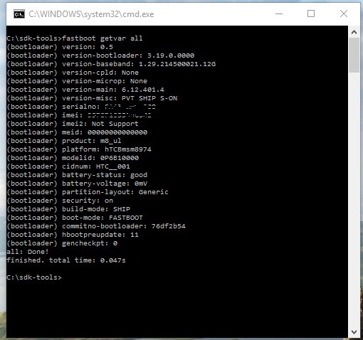

If someone is willing to help, just let me know what i need to do/provide to fix this. I've attached a read of details from the phone using the SDK tools i read on another thread. Not sure if its relevant or not.

(bootloader) version: 0.5
(bootloader) version-bootloader: 3.19.0.0000
(bootloader) version-baseband: 1.23.213311711.05G
(bootloader) version-cpld: None
(bootloader) version-microp: None
(bootloader) version-main: 4.30.720.5
(bootloader) version-misc: PVT SHIP S-ON
(bootloader) serialno: removed
(bootloader) imei: removed
(bootloader) imei2: Not Support
(bootloader) meid: 00000000000000
(bootloader) product: mels_tuhl
(bootloader) platform: hTCBmsm8974
(bootloader) modelid: 0P6B90000
(bootloader) cidnum: HTC__038
(bootloader) battery-status: good
(bootloader) battery-voltage: 0mV
(bootloader) partition-layout: Generic
(bootloader) security: on
(bootloader) build-mode: SHIP
(bootloader) boot-mode: FASTBOOT
(bootloader) commitno-bootloader: 9d5c42de
(bootloader) hbootpreupdate: 11
(bootloader) gencheckpt: 0
