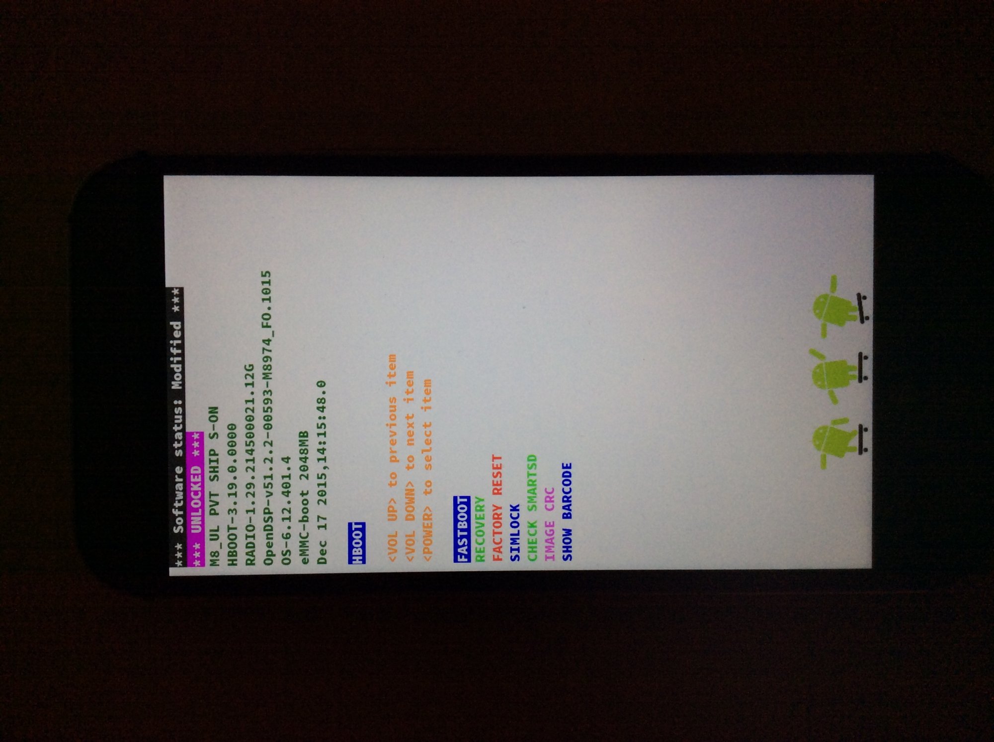

Okay, so earlier this week the latest marshmallow update popped up and so as usual I began downloading and installing it. I left my phone on charge, pressed update and left it. During install the phone restarted per usual but came to a black screen with a red triangle with exclamation mark (uh oh!).
I searched online and found how to get to the bootloader. Tried rebooting several times but no luck. I went to recovery, cleared cache, rebooted and nothing happened. Then chose factory reset (I have a backup). still no luck rebooting. Followed many guides on how to fix it using TWRP and placing img files on sd card. Now my phone just powers on to bootloader every time. I can still get into TWRP and fastboot and such.
I am quite certain that my phone has been completly wiped, drivers an all except the OS is still displayed in the bootloader. I just want my phone to be working again.
HTC One M8 unlocked, current carrier: giffgaff (O2 network)
images attached. couldn't rotate them.
Please help ASAP

It looks like some or maybe all the firmware installed ok from what the OS line in bootloader is reporting. But we don't know how much unfortunately.

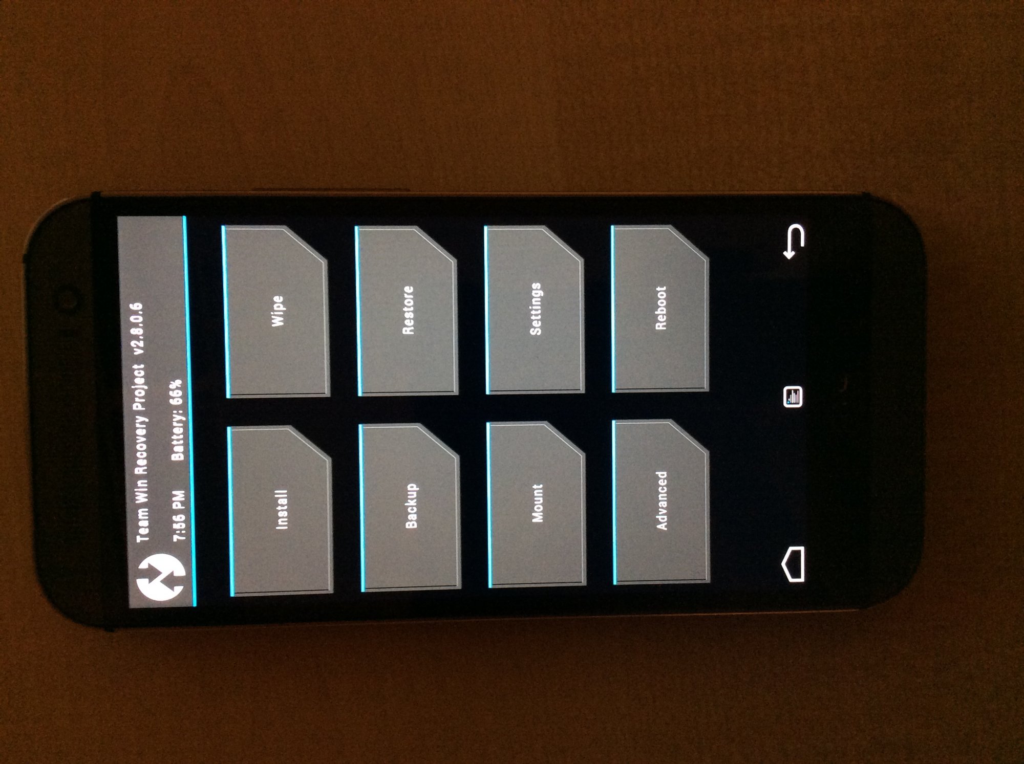

I installed TWRP to then use img files, flashing, etc. which strangely enough stopped the black screen with red error triangle/exclamation mark after start-up screen(white screen/green HTC logo). now phone just goes to bootloader on start-up.

Quick test. Don't worry about ish debugging, doesn't affect fastboot. Can you switch bootloader to fastboot (from your first pic, use vol down key to highlight fastboot in the menu, and power to select) and connect to pc, and check screen to make sure it shows:
fastboot usb
Just to clarify, make sure you exit HTC Sync fully. With the phone in fastboot when you connect to PC, on the phone screen do you see "fastboot usb" or not?
With HTC Sync installed you should have correct drivers, so PC should recognise the phone in fastboot mode.
Ah i see, yes it switches to fastboot usb.

4) Then we need to check you can get in to TWRP ok, on phone bootloader screen use vol down to highlight HBOOT from the menu and press power button to select. Wait until HBOOT finishes check (some green text appearing on screen), then select RECOVERY from menu using vol down and pressing power to select.
This should load TWRP. Then you want to do the restore of the backup you downloaded, so select Restore to get into the restore screen. Now you need to point TWRP to your external SD card, look for the line of text in restore screen that will say something like Internal Storage, press on it and then select External SD Card (or might be Micro sd card, can't recall off the top of my head) - it should be obvious which to select. You should then see the backup listed.
Press on backup name, you should then see a screen with various partitions to restore selected (ticked), there should at least be Boot, System and Data. Then at the bottom swipe the slider left to right to start the restore.
At this point, once restore has completed successfully, I would reboot phone and check it boots ok and complete initial set-up before moving on to the stock recovery step. If it boots ok, you might have to reboot back in to TWRP and do a data only wipe if there are any artifacts hanging around from the backup you have just restored. Let me know if that's the case.
