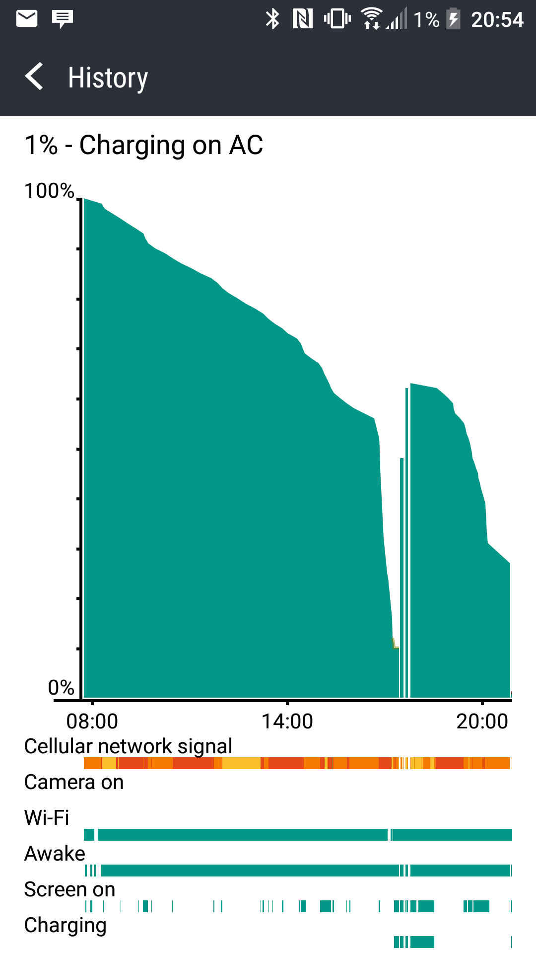

My battery hits 50% and then it drains completely. You can see the drop in the attached picture, all I do it's activate the screen and then boom it dies . I'm about 5 months away from an upgrade, is this done on purpose to make you upgrade?
No. My last HTC lasted 4.5 years without anything like this happening, and my wife's HTC 10 is a year older than your phone without problems. Of course battery longevity depends on usage, and like any manufactured component you will get some sample variation, but no, there is no evil plan to force people to upgrade early.
To be honest it might just be a bad calibration: your screenshot shows it doing it once, but then going much lower than that without dropping in the same way. I don't normally recommend using a phone until it runs flat (doing that regularly is bad for the battery), but if it does run until the phone shuts down try leaving it turned off and charging it fully: charging through a complete cycle may help the calibration.

These two images are from different days:
I took the left image as it was dropping down, it went to 0% soon after.
The right image shows that it dropped off entirely without warning.
It's as if the battery charge isn't being tracked while the screen is off, even though it's still draining. Then when you turn it on, it updates it to reveal that it is very close to dead.
One suggestion I've read is that the phone uses more power to maintain a connection at low signal strength. You can see that power drops off hard when the cellular network signal gets in the red, so this might be part of the problem. In the right hand image you can see the signal has been in the red for some time, and then when the screen briefly comes on, the phone dies.
The image isn't showing, so I can't see how bad it is. But while it is true that a phone uses more power when the signal is weak it's not a catastrophic thing: it will run down in hours, not minutes.
