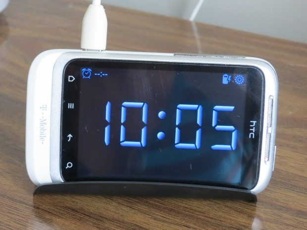

I solved that problem by adding a charger onto my night stand and plugging it in every night.... i also have one in my car, in case i need to charge it, but i haven't had a need for that in a while.... I also got a business card stand for $1.99 that i keep my phone on... it's great!!
