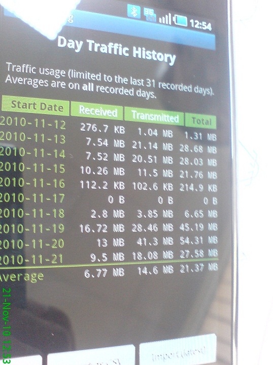

e.g.2 in my second phone (actually my friend's) he started to using the device and the 3G watchdog on Nov 5th (attached is his daily log from 3G watchdog) it seems there is a very high upload activity with 14 mb on average per day sometimes up to near 40mb/day
my friend quota was 250mb/month and the 3G watchdog + APNDroid again did a good job by terminating the connection when it is 99%.
but unfortunately when we checked it with the provider it was 490mb usage !!!! (1 mb extra will cost $0.53) and that is a lot of money.
again one day later (today) it is 502 mb !!!!!
I am really don't know what is happening here and why it is giving different numbers than the provider's ALSO I am not sure where is this upload activities is coming from .

I contacted 3G Watchdog developer about the exact problems and that was his reply
[FONT=&quot]First, in cas you may wonder, 3GW does not send (nor receive) any data on the internet mobile connection, it just counts the traffic. It just can't do it because it has not the permission to access the network, it can just view its state (i.e. connected or not). You can check this by going to phone settings > Applications > Manage applications > 3G watchdog > permissions. You'll see that 3GW has the "view network state" permission, but not the "full internet access" required for receiving/sending data.
3GW makes request to APNdroid to turn the mobile data connection off. If your provider is still counting something after that, that means that either the connection is not really off (APNdroid's fault), or there is another kind of connection not intercepted by APNdroid, or your provider is just abusing you - but if 3GW also reports a high outgoing traffic, that must be that something in the phone really sends data.
To know which app sends what, and if you are on Android 2.2, I suggest that you install the "TrafficStats Lite" app (requires 2.2). It will show you the usage for each app.
Good luck.
Best
Richard
[/FONT]

After all I discovered that the problem is the "Whatsapp messenger" app
I even contacted the developers and they admit the issue and that was few months earlier.. they promise to fix it in the next update and I haven't checked since then
there was another app "traffic status lite" which show the data consumption for each app in the device that uses the data
you should give it atry especially if your wife use whatsapp messenger
