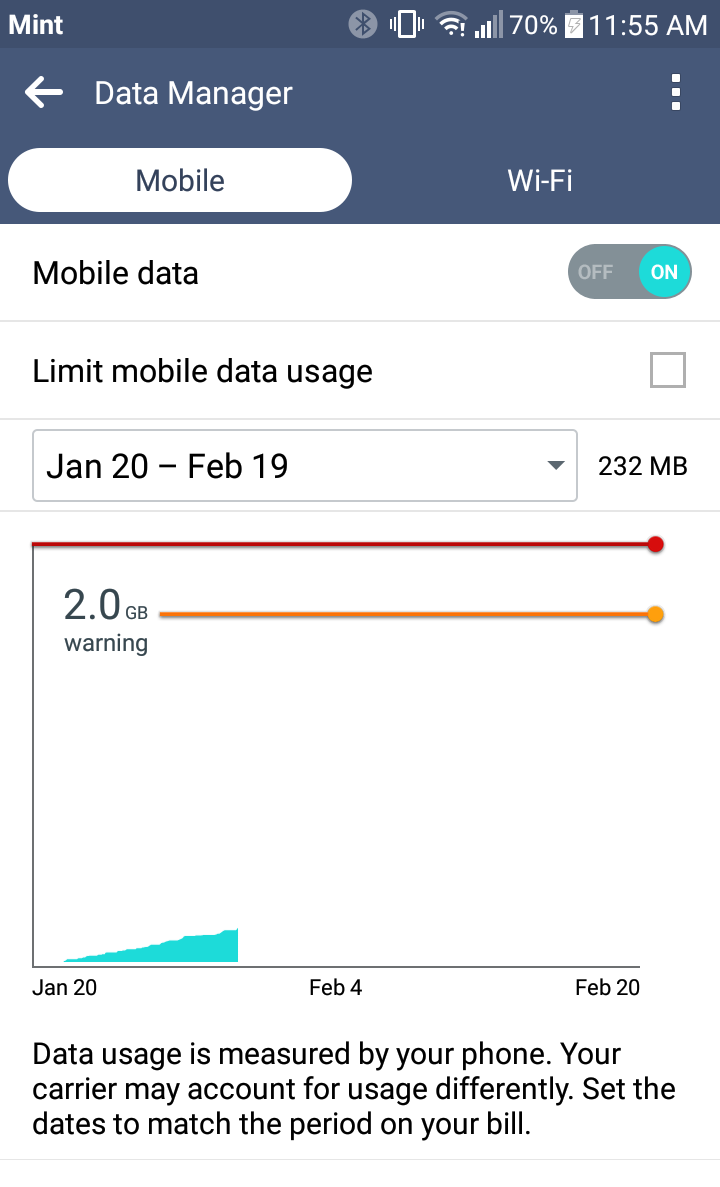

You are sure that WiFi is connected? How about a data manager? If you have one, it might have detected a threshold and turned data off. (Just guessing).

Wifi is connected. It states "Internet unavailable". The data manager might be of interest. I went into it, disabled mobile data, and it worked for a moment, then stopped again. Here's a screen shot of the data manager:
