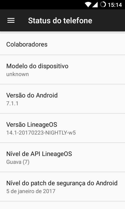

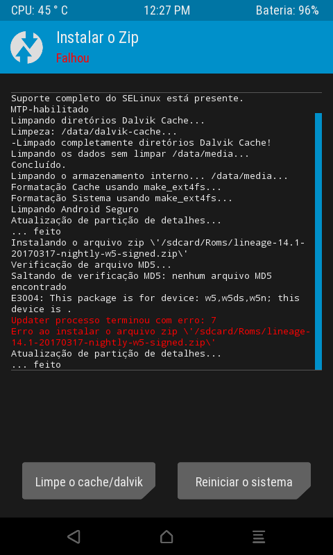

Hello, recently I installed LineageOS 14.1 along with the GAPPS pico, but I noticed that my cell phone was quite slow, so I decided to switch to Ressusrection Remix, but at the time of installation, TWRP charges that the device model is not compatible with the ROM I'm trying to install(my device is a LG L70 D325f8, but i don't know why, the device name shows "unknown"). I tried to change the build.prop, but no sucess. Then I tried to change the binary-update to bypass the model checking, but the TWRP charges that the zip is not valid.
Does anyone know how to solve this problem or how to zip files to flash properly?
This is the error that TWRP shows when I try to install any ROM.

What I did was edit (with Notepad++, because Windows Notepad corrupts the file) the 'updater-script' (a file located in the Zip of any ROM, in name-of-your-rom.zip\META-INF\com\google\android) by deleting the first few lines of the code, specifically that part here:
assert (getprop ("ro.product.device") == "w5" || getprop ("ro.build.product") == "w5" || getprop ("ro.product.device") == "w5ds "Getprop (" ro.build.product ") ==" w5ds "|| getprop (" ro.product.device ") ==" w5n "|| getprop (" ro.build.product ") ==" W5n "|| abort (" E3004: This package is for device: w5, w5ds, w5n; this device is "+ getprop (" ro.product.device ") +". "); );
This part verifies that the device is even an L70 or derived from the L70, then deleting that part causes the ROM to be installed independently of the model.
Then I put the file back (use WinRar for this, otherwise TWRP will accuse the ZIP is invalid) in the .ZIP of rom, put it on the sdcard and installed it without problems.

@Jovi1
Device model does not appear
ROM installed but at the time of reboot starts goes straight pro twrp had to reboot the cell phone
Sorry my English ;)
Device : LG L70 D325f8

Reinstall Or Update TWRP.
You can update TWRP within TWRP
1.Just download Latest TWRP ver from official site or some other trusted website.
2.Copy it to phone, by OTG, SDcard or something.
3.Select "install" option in TWRP
3.Select "image" option probably bottom screen of install page.
4.Select the new TWRP image file.
5.SELECT THE TYPE ""RECOVERY"" when prompted.
and flash it.
now power off from recovery and boot again into recovery, it should be updated.
After all this try installing your ROM, The phone should detect its model.
