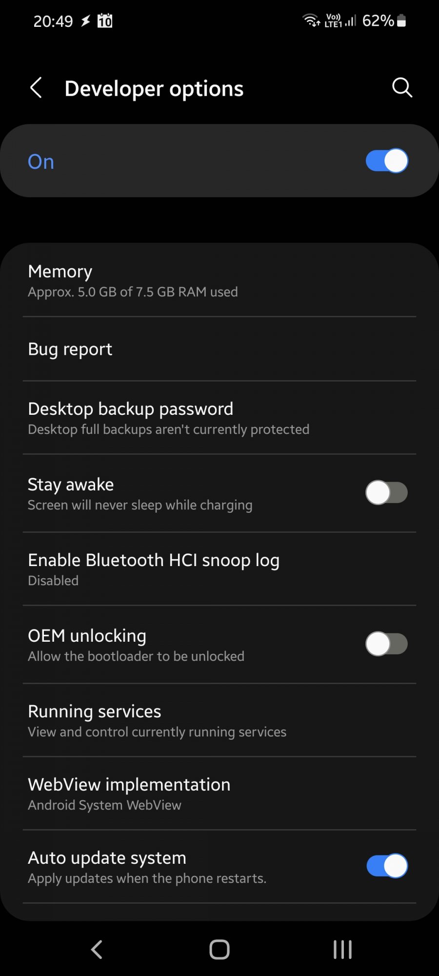

Please I need your help? Could you send me a photo of where the OEM Unlock/Lock Option will be located.
To enable developer options:
1. Go to your phones Settings menu.
2. Tap About Phone.
(some phones will have it in a different but similar location)
3. Repeatedly tap the build number until it says you are a developer.
4. The developer option will now be in your phones Settings menu.
When you tap developer options the OEM unlock selection is near the top, you don't have to scroll down.
It looks like everyone who has answered you so far doesn't know much about this topic, because "OEM Unlock" doesn't exist on phones from the US. That's only for international versions, from other countries.
However, there IS a way to do the bootloader unlock, as long as the phone isn't running the very newest/latest software version. So what's the Baseband Version on the device? You can find that under Settings-->About-->Software Information
