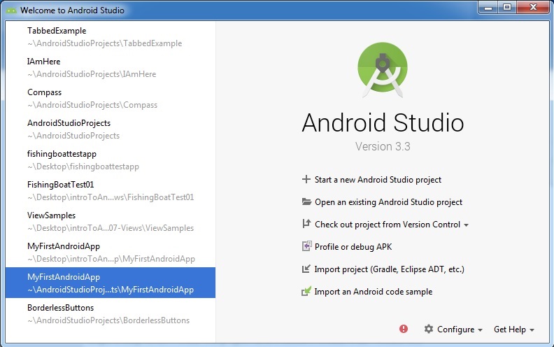

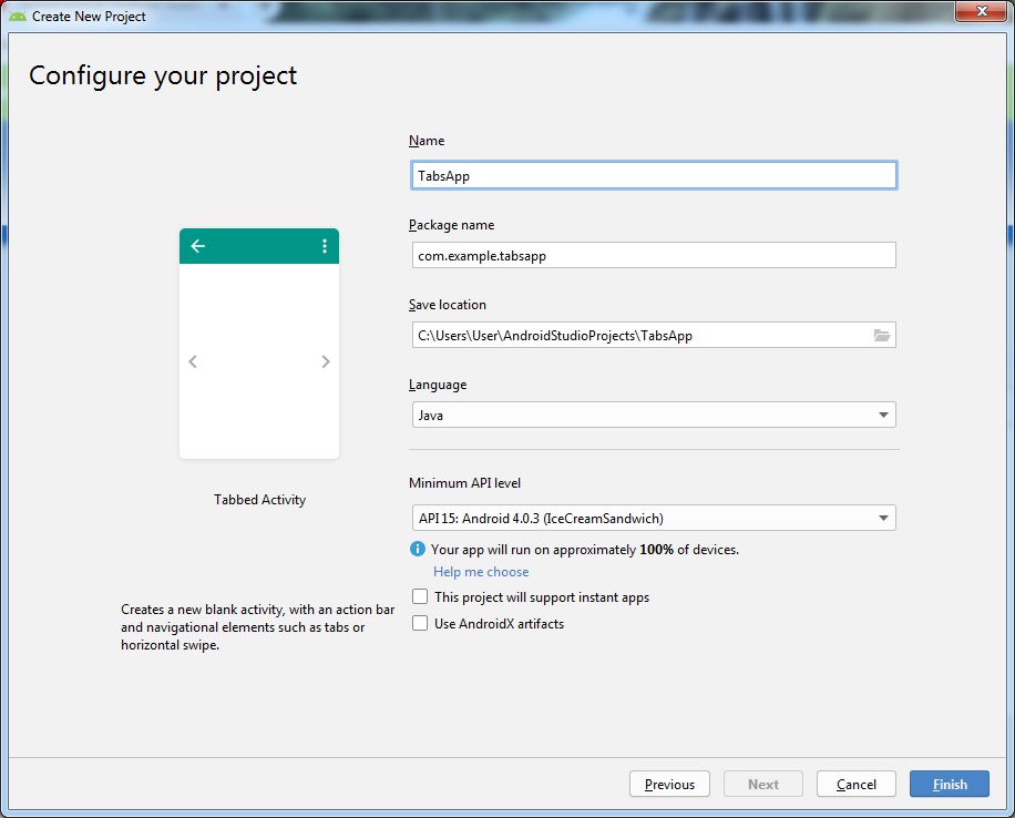

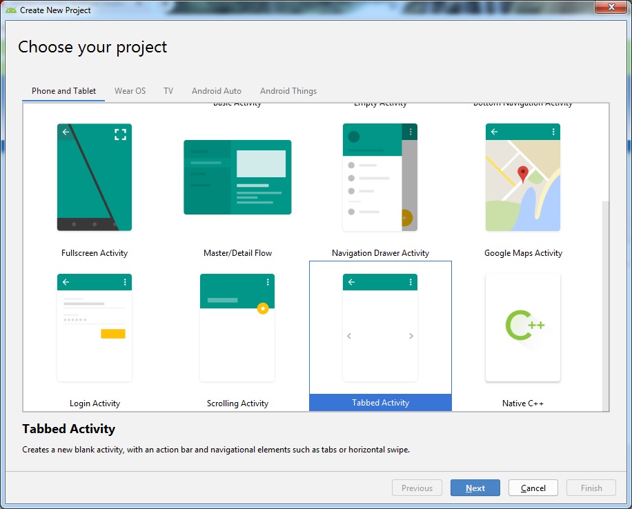

I have seen a few videos regarding bluetooth and tabbed activity but my android studio
skips a step when I creat the project and it doesn't create it as I would like. In last step of
creating the project the selection of Activity Name and Navigation Style doesn't show up.
Can anyone help me for a start creat an app with 3 tabs

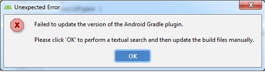

When I try to upgrade the plugin I get the attached error file.
What should I do?

I changed my file build.gradle (Module:app) to:
Code:
apply plugin: 'com.android.application'
android {
    compileSdkVersion 28
    defaultConfig {
        applicationId "com.example.tablayout"
        minSdkVersion 16
        targetSdkVersion 28
        versionCode 1
        versionName "1.0"
        testInstrumentationRunner "android.support.test.runner.AndroidJUnitRunner"
    buildTypes {
        release {
            minifyEnabled false
            proguardFiles getDefaultProguardFile('proguard-android-optimize.txt'), 'proguard-rules.pro'
dependencies {
    implementation fileTree(dir: 'libs', include: ['*.jar'])
    implementation 'com.android.support:appcompat-v7:28.0.0'
    implementation 'com.android.support.constraint:constraint-layout:1.1.3'
    implementation 'com.android.support:support-v4:28.0.0'
    testImplementation 'junit:junit:4.12'
    androidTestImplementation 'com.android.support.test:runner:1.0.2'
    androidTestImplementation 'com.android.support.test.espresso:espresso-core:3.0.2'
    implementation 'com.android.support:design:28.0.0'                                                                <----- changed from compile to implementation
I have changed the last line of this file from
Code:
compile 'com.android.support:design:28.0.0'
to
Code:
Now runs ok and I have finished the tutorial at https://www.codingdemos.com/android-tablayout-example-viewpager/

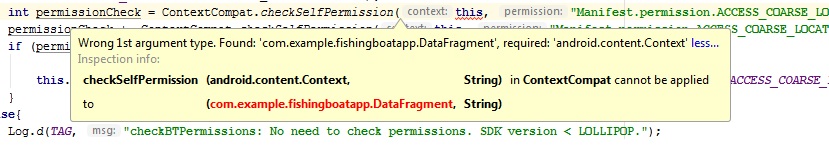

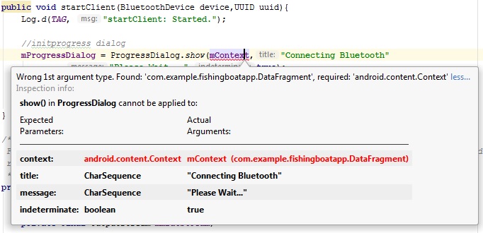

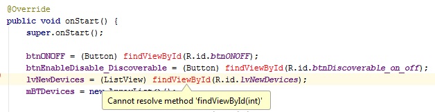

Now I have this code for connecting to HC-05 bluetooth module.
Do I place this code to fragment_data.xml file?
Code:
package com.introtoandroid.fishingboattestapp;
import android.Manifest;
import android.bluetooth.BluetoothAdapter;
import android.bluetooth.BluetoothDevice;
import android.content.BroadcastReceiver;
import android.content.Context;
import android.content.Intent;
import android.content.IntentFilter;
import android.os.Build;
import android.support.v7.app.AppCompatActivity;
import android.os.Bundle;
import android.util.Log;
import android.view.View;
import android.widget.AdapterView;
import android.widget.Button;
import android.widget.ListView;
import java.util.ArrayList;
import static android.graphics.Color.rgb;
public class MainActivity extends AppCompatActivity implements AdapterView.OnItemClickListener {
    private static final String TAG = "MainActivity";
    BluetoothAdapter mBluetoothAdapter;
    Button btnONOFF;
    Button btnEnableDisable_Discoverable;
    public ArrayList<BluetoothDevice> mBTDevices = new ArrayList<>();
    public DeviceListAdapter mDeviceListAdapter;
    ListView lvNewDevices;
    //BluetoothConnectionService mBluetoothConnection;
    Button btnStartConnection;
    // Create a BroadcastReceiver for ACTION_FOUND
    private final BroadcastReceiver mBroadcastReceiver1 = new BroadcastReceiver() {
        public void onReceive(Context context, Intent intent) {
            String action = intent.getAction();
            // When discovery finds a device
            if (action.equals(mBluetoothAdapter.ACTION_STATE_CHANGED)) {
                final int state = intent.getIntExtra(BluetoothAdapter.EXTRA_STATE, mBluetoothAdapter.ERROR);
                switch (state) {
                    case BluetoothAdapter.STATE_OFF:
                        Log.d(TAG, "onReceive: STATE OFF");
                        break;
                    case BluetoothAdapter.STATE_TURNING_OFF:
                        Log.d(TAG, "mBroadcastReceiver1: STATE TURNING OFF");
                        break;
                    case BluetoothAdapter.STATE_ON:
                        Log.d(TAG, "mBroadcastReceiver1: STATE ON");
                        break;
                    case BluetoothAdapter.STATE_TURNING_ON:
                        Log.d(TAG, "mBroadcastReceiver1: STATE TURNING ON");
                        break;
     * Broadcast Receiver for changes made to bluetooth states such as:
     * 1) Discoverability mode on/off or expire.
    private final BroadcastReceiver mBroadcastReceiver2 = new BroadcastReceiver() {
        @Override
            final String action = intent.getAction();
            if (action.equals(BluetoothAdapter.ACTION_SCAN_MODE_CHANGED)) {
                int mode = intent.getIntExtra(BluetoothAdapter.EXTRA_SCAN_MODE, BluetoothAdapter.ERROR);
                switch (mode) {
                    //Device is in Discoverable Mode
                    case BluetoothAdapter.SCAN_MODE_CONNECTABLE_DISCOVERABLE:
                        Log.d(TAG, "mBroadcastReceiver2: Discoverability Enabled.");
                        break;
                    //Device not in discoverable mode
                    case BluetoothAdapter.SCAN_MODE_CONNECTABLE:
                        Log.d(TAG, "mBroadcastReceiver2: Discoverability Disabled. Able to receive connections.");
                        break;
                    case BluetoothAdapter.SCAN_MODE_NONE:
                        Log.d(TAG, "mBroadcastReceiver2: Discoverability Disabled. Not able to receive connections.");
                        break;
                    case BluetoothAdapter.STATE_CONNECTING:
                        Log.d(TAG, "mBroadcastReceiver2: Connecting....");
                        break;
                    case BluetoothAdapter.STATE_CONNECTED:
                        Log.d(TAG, "mBroadcastReceiver2: Connected.");
                        break;
     * Broadcast Receiver for listing devices that are not yet paired
     * -Executed by btnDiscover() method.
    private BroadcastReceiver mBroadcastReceiver3 = new BroadcastReceiver() {
        @Override
            Log.d(TAG, "onReceive: ACTION FOUND.");
            if (action.equals(BluetoothDevice.ACTION_FOUND)){
                BluetoothDevice device = intent.getParcelableExtra (BluetoothDevice.EXTRA_DEVICE);
                mBTDevices.add(device);
                Log.d(TAG, "onReceive: " + device.getName() + ": " + device.getAddress());
                mDeviceListAdapter = new DeviceListAdapter(context, R.layout.device_adapter_view, mBTDevices);
                lvNewDevices.setAdapter(mDeviceListAdapter);
     * Broadcast Receiver that detects bond state changes (Pairing status changes)
    private final BroadcastReceiver mBroadcastReceiver4 = new BroadcastReceiver() {
        @Override
            if(action.equals(BluetoothDevice.ACTION_BOND_STATE_CHANGED)){
                BluetoothDevice mDevice = intent.getParcelableExtra(BluetoothDevice.EXTRA_DEVICE);
                //3 cases:
                //case1: bonded already
                if (mDevice.getBondState() == BluetoothDevice.BOND_BONDED){
                    Log.d(TAG, "BroadcastReceiver: BOND_BONDED.");
                //case2: creating a bone
                if (mDevice.getBondState() == BluetoothDevice.BOND_BONDING) {

**Update 11/04/2019:**
I have made changed to my code and placed bluetooth code into fragment.
I get the following errors:
Code:
private void checkBTPermissions() {
        if(Build.VERSION.SDK_INT > Build.VERSION_CODES.LOLLIPOP){
            int permissionCheck = this.checkSelfPermission("Manifest.permission.ACCESS_COARSE_LOCATION");
            permissionCheck += this.checkSelfPermission("Manifest.permission.ACCESS_COARSE_LOCATION");
            if (permissionCheck != 0) {
                this.requestPermissions(new String[]{Manifest.permission.ACCESS_FINE_LOCATION, Manifest.permission.ACCESS_COARSE_LOCATION}, 1001); //Any number
        }else{
            Log.d(TAG, "checkBTPermissions: No need to check permissions. SDK version < LOLLIPOP.");
Errors In lines
Code:
Error: 'Cannot Resolve Method 'checkSelfPermission(java.lang.String)'
How do I fix this?
use
Code:
ContextCompat.checkSelfPermission(this, "Manifest.permission.ACCESS_COARSE_LOCATION");
use
Code:
Hi!. Just did and gives me an error. It doesn't like first argument 'this' of checkSelfPermission()
see image:
Also I get errors on the onStart()
Code:
@Override
public void onStart() {
    super.onStart();
    btnONOFF = (Button) findViewById(R.id.btnONOFF);
    btnEnableDisable_Discoverable = (Button) findViewById(R.id.btnDiscoverable_on_off);
    lvNewDevices = (ListView) findViewById(R.id.lvNewDevices);
    //Broadcasts when bond state changes (ie:pairing)
    IntentFilter filter = new IntentFilter(BluetoothDevice.ACTION_BOND_STATE_CHANGED);
    getActivity().registerReceiver(mBroadcastReceiver4, filter);
    mBluetoothAdapter = BluetoothAdapter.getDefaultAdapter();
    lvNewDevices.setOnItemClickListener(DataFragment.this);
    btnONOFF.setOnClickListener(new View.OnClickListener() {
        @Override
        public void onClick(View v) {
            enableDisableBT();
findViewById gives an error.
That's because the first argument needs to be of type Context, which would be an Activity class, not a Fragment.
Hi. My Activity Class is:
Code:
package com.example.fishingboatapp;
import android.support.design.widget.TabItem;
import android.support.design.widget.TabLayout;
import android.support.v7.widget.Toolbar;
import android.support.v4.view.ViewPager;
public class MainActivity extends AppCompatActivity {
    Toolbar toolbar;
    TabLayout tabLayout;
    ViewPager viewPager;
    PageAdapter pageAdapter;
    TabItem tabChats;
    TabItem tabStatus;
    TabItem tabCalls;
    @Override
    protected void onCreate(Bundle savedInstanceState) {
        setContentView(R.layout.activity_main);
        toolbar = findViewById(R.id.toolbar);
        toolbar.setTitle(getResources().getString(R.string.app_name));
        setSupportActionBar(toolbar);
        tabLayout = findViewById(R.id.tablayout);
        tabChats = findViewById(R.id.tabChats);
        tabStatus = findViewById(R.id.tabStatus);
        tabCalls = findViewById(R.id.tabCalls);
        viewPager = findViewById(R.id.viewPager);
        pageAdapter = new PageAdapter(getSupportFragmentManager(), tabLayout.getTabCount());
        viewPager.setAdapter(pageAdapter);
        viewPager.addOnPageChangeListener(new TabLayout.TabLayoutOnPageChangeListener(tabLayout));
So what the first argument should be?
            int permissionCheck = ContextCompat.checkSelfPermission(getContext(), "Manifest.permission.ACCESS_COARSE_LOCATION");
            permissionCheck += ContextCompat.checkSelfPermission(getContext(), "Manifest.permission.ACCESS_COARSE_LOCATION");

    public void startClient(BluetoothDevice device,UUID uuid){
        Log.d(TAG, "startClient: Started.");
        //initprogress dialog
        mProgressDialog = ProgressDialog.show(mContext,"Connecting Bluetooth"
                ,"Please Wait...",true);
        mConnectThread = new ConnectThread(device, uuid);
        mConnectThread.start();

I get an error in this line of the BluetoothConnectionService.java file:
Code:
Error: see attached image
How do I solve this?
