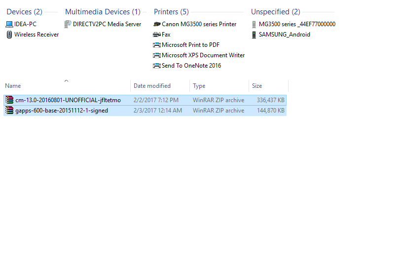

I have the required files but for some reason my laptop cant detect my phone correctly
Do you have a micro SD card and a card reader for your PC?
If so, copy the ROM and Gapps directly to the SD card and put it back in phone. Then use Philz to flash from the card.
OR you can use a MicroSD adapter and put your sdcard in it and load the zip into the root if the sdcard and put the sdcard back in the phone and install the os
I don't have a MicroSD adapter on my computer. Is there a way i can load CM13 and GApps thru odin?
All i can say is reinstall the atock firmware root it then download the cm13 to your phone from its browser and then reinstall the CM13 OS
