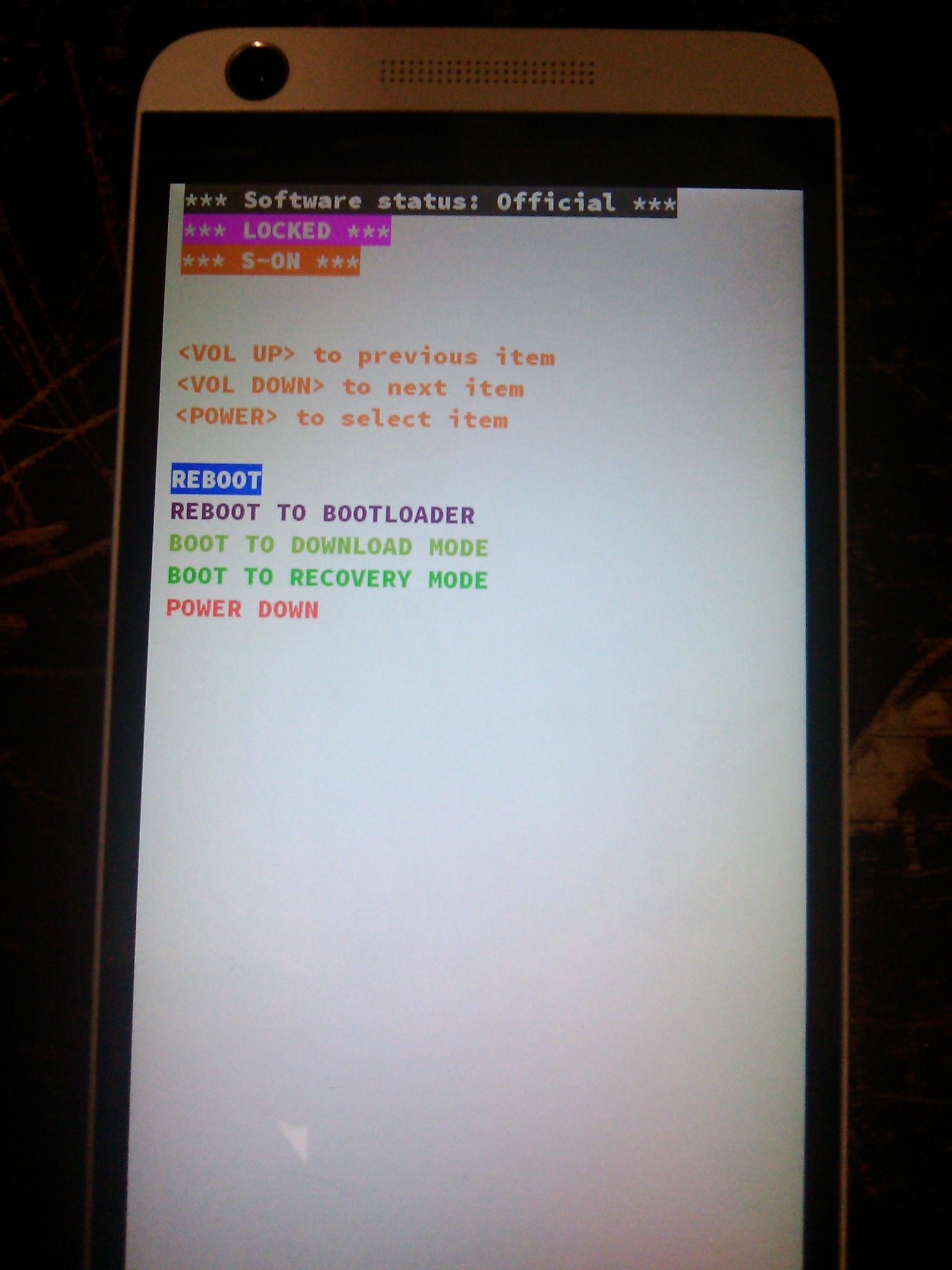

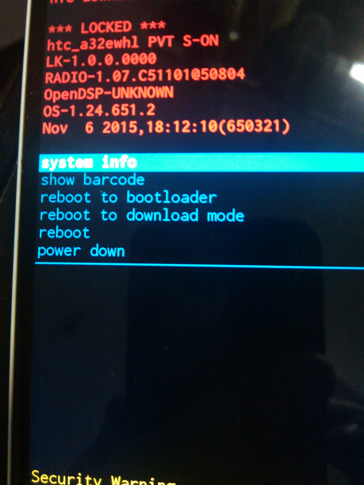

You say I have a fastboot in my bootloader menu. Look at the screen capture pictures bellow. I don't see any line marked "fastboot". And there is no fastboot check box in system > power. So what next?

To get the picture on the left I hold down the power and volume down buttons untill I feel the phone buzz. The picture on the right is a sub menu under the "reboot to bootloader" line. A PS I have all the needed files downloaded to my laptop

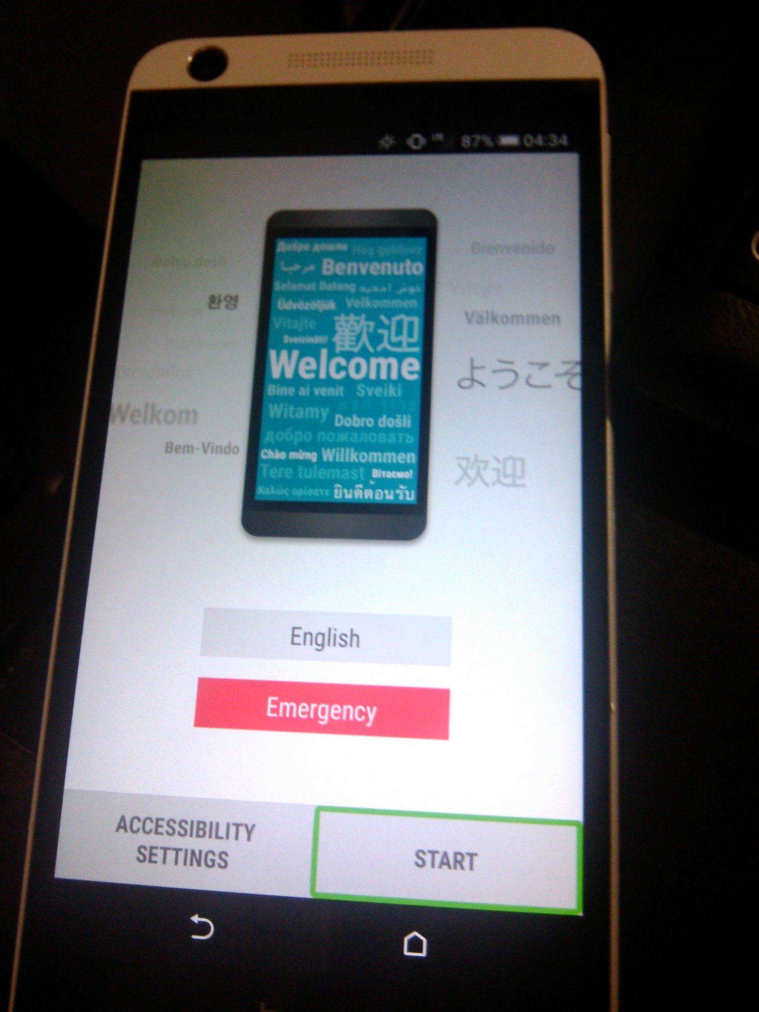

But now I have a new problem. The setup was asking to hit a button to select which language I wanted. English was the top bar and French is the next one down. Some how French was selected. Now the phone is stuck in a voice instruction loop. I can't kill the loop because I don't speak French and I can't power down the phone. The long hold on the power button isn't working. Normally at this point I would open the phone up and pull the battery. I can't see any way to open it up and pull the battery.
I finely got the long hold power button figured out. It is volume up + long hold power button. And I got the phone back to speaking and showing English. But I still can't get past the picture that I screen captured picture bellow with the camera in my room mates phone. The phone is stuck there. The only way to power down the phone is with the long hold power + volume up. I can get into the bootloader and it says on top "HTC download mode" and the next line down ***unlocked***. I am assuming that the rest of the rooting has to be done before the phone is ready to be used. Kind of like the old IDE hard drives. When they came brand spanking new in the box. They had to be low level formatted, then the partition then finely the high format. And the low level format only had to be done 1 time in a hard drive's life time.
Hmm, that's certainly a different bootloader than any I've seen before. I'd heard rumours that there were devices coming that used something less HTC-like than the usual hboot, but had never encountered one. But OK, it sounds like it's been unlocked.
However, unlocking by itself shouldn't affect the phone's function: it just allows fastboot to overwrite or erase partitions that it wouldn't be able to do on a locked phone. Unlocking does perform a factory reset, but that wouldn't stop the phone booting since it doesn't affect the system software. The rooting process is unlock bootloader, install custom recovery (which needs the bootloader unlocking), use recovery to install the files that give you root access. Only the last state modifies the Android system, and that only by adding a few things to it. So you really should still be able to boot normally after unlocking.
So first thing to check: how exactly did you unlock it, i.e. what commands did you type? And did you do anything other that issue the unlock command?
I got the phone partly working. It works now except for the fact that I have to fast dbl tap everything and I can't shut down the voice cmd notification.
Right, just come back now (only for a minute, taking a break from other tasks). That recent picture looks like the "start up" dialogue after a factory reset, but I guess you've figured that out. You shouldn't need to worry about the RUU bit: that's only for really old phones, i.e. predating the HTC bootloader unlocking programme. If the phone is unlocked that bit wasn't needed.
Don't understand about the "fast double tap" problem (my instinct is to look at gesture and accessibility settings, but it seems an unlikely thing). Is this voice command thing a "Google Now" type feature, or some accessibility thing? I'm asking because I uninstall that type of stuff myself, so am not very familiar with it.

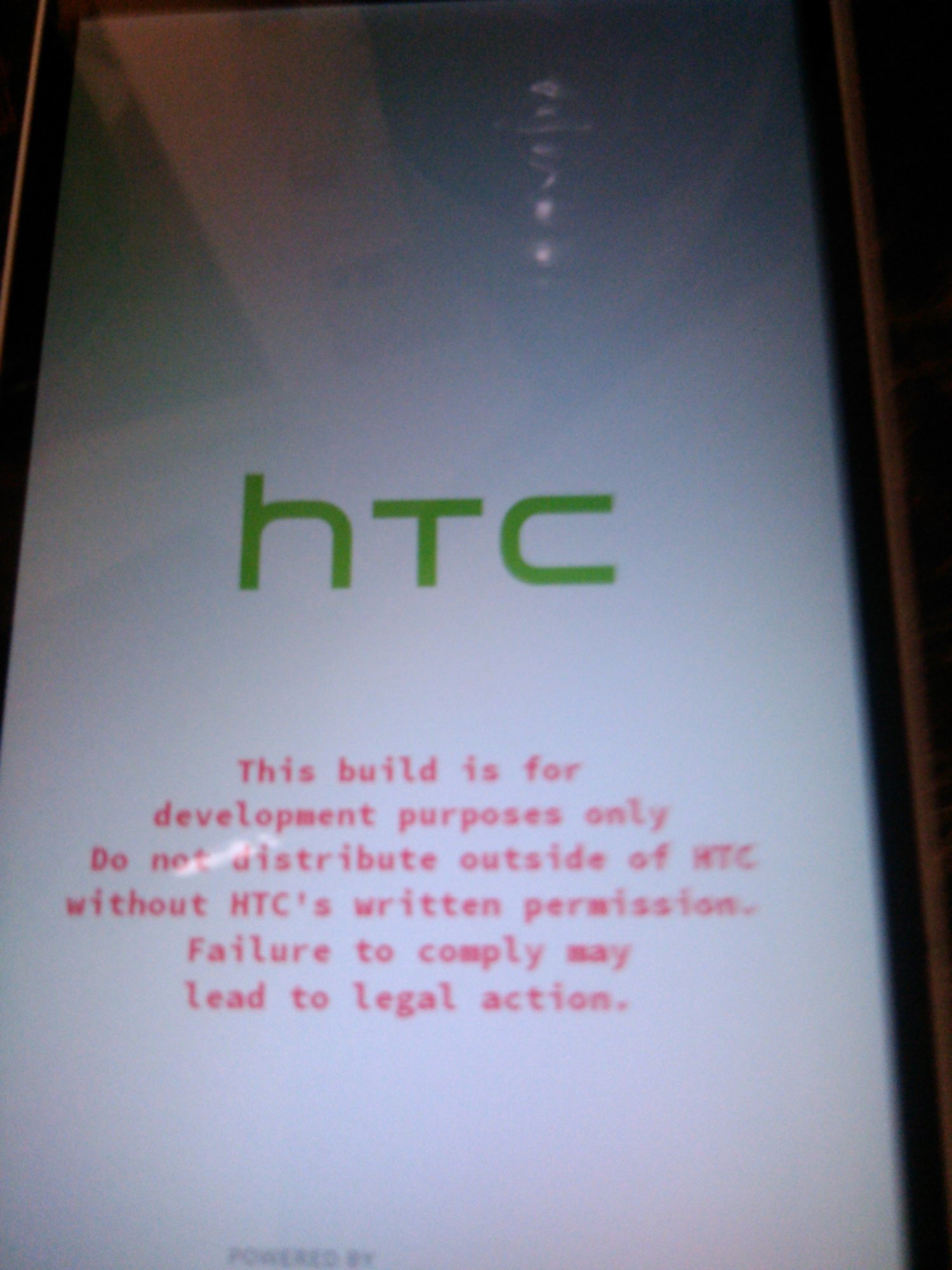

I have a new problem. I may have flashed the wrong img file. And I can't find were I got it from. I have been looking at so many web pages tonight looking for the right instructions.
I followed the following instructions bellow. And all the phone does now is what is in the picture bellow. the screen is black > I press and hold the power + volume up and the screen bellow pops up for a second and the screen goes black again.

The flashing went fine. Then as instructed I went to reboot to download mode, then to boot recovery mode to start moving to the dir were the SuperSU.zip file is. Thats when the screen just went black. And thats the way the phone sits now. Did I just brick my phone? :-(
By the way the name of the img file was "stock (something) recovery.img". What the 2nd word is were the word "something" is I have no clue as to what that word is.

A new development. Just before shutting down the laptop to rack out. I decided to give the phone one more go at long hold power + volume up. And LO AND BEHOLD the phone shut down and restarted 100% NORMAL. Everything works. I don't know what took place but the phone sat undisturbed for about an hour and a half. The app "root checker" still reports that the phone isn't rooted yet. But at lease the phone isn't bricked. :-D
Steve
Does anyone have any clue as to why the phone went into that mode in the picture above? And how to complete the rooting?
