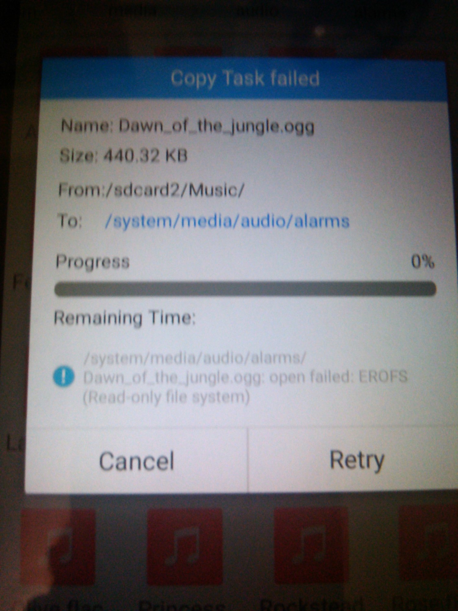

I need to unlock the system directory and the sub dir's under it. I want to add some extra ringtones in my phone. The dir were the ringtones go is locked with a read only cmd. I know how to unlock Windows dir's but I don't know the Android cmd. I think it is a simple thing to do. I just don't know how.

I have tried just coping the sound file from the SD card to the place that the alarm ringtones are in. And I keep getting the same error message saying that place were I want to place the ringtone is a write protected dir. See the picture bellow.

Just in case you ever need it or can use it:
mount -o remount,rw /system
That doesn't always work, though, depending on your version of Android and often takes a device-specific version:
mount -o remount,rw <device> /system
where <device> is the path name to the system partitions /dev/block entry
Remounting back to read-only is the same command with just changing "rw" to "ro".
Also note / remember that when the multi-users were supported in Android (4.x?), the mount behavior does not get communicated outside of the process that issued the mount command. So, you can't use the above mount in an adb command expect that an app would see the results of the mount behavior. You'd have to finish doing your stuff from the same process (i.e., adb or the terminal emulator, etc.).
The place you are trying to copy to in that picture is in /system, which you will not be able to write to from Android unless you are S-Off (and have mounted the partition read-write).
But did you try just copying to /sdcard/Ringtones instead (or /sdcard/Notifications. Actually I have a /sdcard/Alarms too, but that is empty)? I use HTC devices and I do not need to copy my ringtones into the system folder.
The ringtone is on the sdcard but not in Notifications. The files are in download. I was able to set the ringtones by going into sound & notification > alarm and hit + to select the ringtone that I wanted. Also I was able to do it for the incoming call ringtone. I didn't need to unlock the system dir. But thanks for the notes if I should ever need to remove the write protect down the road. And thanks for the tip on how to add the ringtones without having to unlock the system dir.
