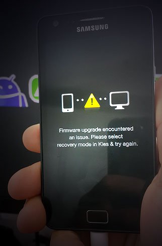

I recently updated my old i9100t to SlimKat and it worked great, the other day I tired to flash the rom to something else and now I'm stuck with the "Firmware upgrade...." boot screen.
I am able to get the phone into "Download Mode" but nothing works.
Odin keeps faling / timing out.
For the past few days I've tried just about everything I could find online but to no use.
PLEASE HELP.... :saddroid:
Hello everyone, :blushDroid:

I tried this exactly to the "T" many times,,, all I keep getting this this:
<ID:0/004> Added!!
<OSM> Enter CS for MD5..
<OSM> Check MD5.. Do not unplug the cable..
<OSM> Please wait..
<OSM> I9100XXLPQ_I9100OXALPQ_I9100XXLPQ_HOME.tar.md5 is valid.
<OSM> Checking MD5 finished Sucessfully..
<OSM> Leave CS..
<ID:0/004> Odin v.3 engine (ID:4)..
<ID:0/004> File analysis..
<ID:0/004> SetupConnection..
<ID:0/004> Initialzation..
<ID:0/004> Get PIT for mapping..
<ID:0/004> Firmware update start..
<ID:0/004> boot.bin
<ID:0/004> NAND Write Start!!
<ID:0/004> Sbl.bin
<ID:0/004> Complete(Write) operation failed.
<OSM> All threads completed. (succeed 0 / failed 1)
I tried to pit, I tired diff rent Odin,, I can't get another rom on the phone, nor can I boot into recovery... back to square one.
Any other tricks up your sleeve? :saddroid:
