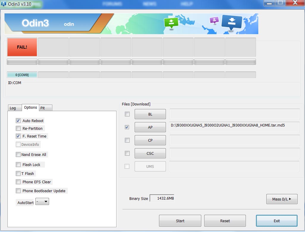

From other threads I've scanned it's not looking too hopeful. Thanks for your replies thus far. I've taken a look at that XDA thread and it seems to be suggesting flash with a collection of files and re-partition and EFS clear boxes checked. I only have the one file and have been flashing the same way I did with the recovery. Should I be trying a re-partition?
When you read thru the thread he list exactly which boxes to check and how to load the files in Odin. Hope it works if you decide to try.
