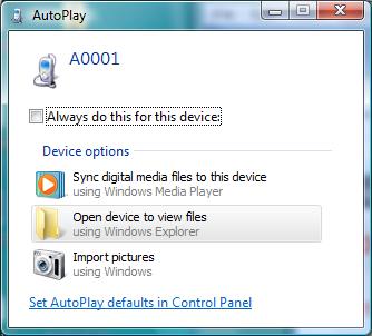

I did what you suggested but still cannot find "Android device" in the Device Mamager of my computer!
Actually, when I connect the phone, in my computer, "AutoPlay" window appears as shown in the attached picture. When click "Open device to view files", I can see the files in my phone, and I can copy the files from my phone to my computer.
However, in the Device Mamager of my computer (Vista), there is no "Android device"!

It looks like your phone is being recognized as a mass storage device only. Try putting your phone into debugging mode.
Unplug your phone. Go to menu>settings>about phone and tap 'build number' multiple times until it says you are now a developer (I've read 7 times, but it might require a few more taps ;) ). Then go back to menu>settings and you should no see 'Developer Options'. Open that and enable USB debugging. No plug your phone back in and see if that let's you load the driver.

A few days ago I have set that in my phone:
Settings -> SYSTEM -> {} Developer Options -> enable Android debugging, enable ADB over network.
If you plug your phone in and your PC recognizes it as a mass storage device, the you must already have a driver installed. What else are you trying to accomplish?
This is true in that as a mass storage device it will use the generic driver that most mass storage devices use, but the phone won't be recognized as an adb device which is what the op needs.
Try this ... unplug the phone from the PC and make sure USB debugging is enabled. Then reboot your PC and once fully booted plug in your phone to a different USB port (try on on the back of the PC) and see if it's recognized that way.
