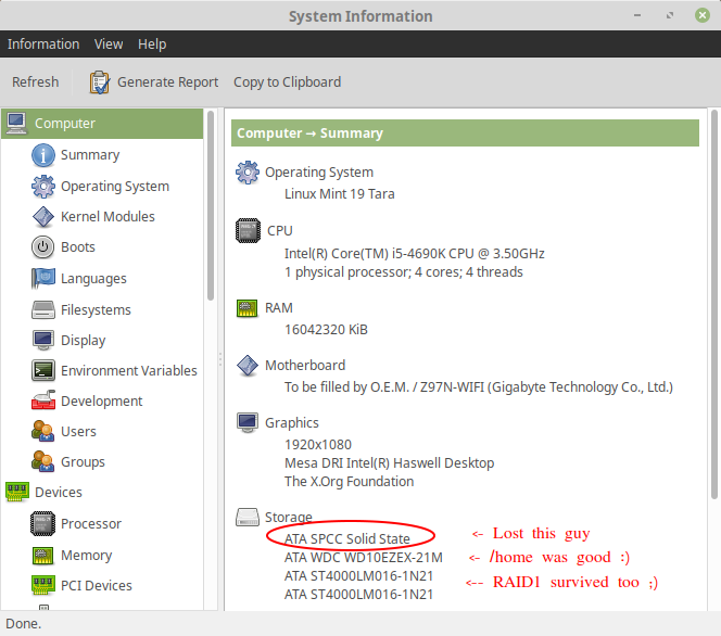

I agree Linux is much better, but I "think" you are referring to a *special* LIVE Distro. Common distros don't include adb and fastboot "Out of the box," and one still needs to setup "Android Rules" once those packages are installed. Pretty sure I know of the one you refer to, but I'm too lazy to look for it at the momentAre you using Windows? Windows is a mega pain in the arse to do anything to Android.. Scratch Windows and try a Linux liveboot disk/USB (they'll leave your Windows OS alone unless you prompt a total installation).. Those don't require drivers or anything for Android, which might make troubleshooting easier
Umm, I talked SuperR into adding ADB & fastboot to his Kitchen .iso's called Mint4Kitchen and Ubuntu4Kitchen.. You can choose your flavor as he posted one for Linux Mint (v18.3 or v19) & Ubuntu (16.04 or 18.04). My fave is Mint because it's really closely setup similar to Windows, making it easier to navigate for ppl normally used to Windows. I am partial to v18.3 until I feel Mint 19 is ready but some ppl prefer Ubuntu anyways.I agree Linux is much better, but I 'think' you are referring to a *special* LIVE Distro. Common distros don't include adb and fastboot 'Out of the box,' and one still needs to setup 'Android Rules' once those packages are installed. Pretty sure I know of the one you refer to, but I'm too lazy to look for it at the moment![]()
EDIT: A link to the speciality ISO would be cool if you have it handy. And if you have a few minutes, please look over my post (#15) above to concur it makes sense. 'Brain Farts' are messing with me a bit today - Thanks!
Very nice - thank you! Point the Winders people to this and it's GOOD!Umm, I talked SuperR into adding ADB & fastboot to his Kitchen .iso's called Mint4Kitchen and Ubuntu4Kitchen.. You can choose your flavor as he posted one for Linux Mint (v18.3 or v19) & Ubuntu (16.04 or 18.04). My fave is Mint because it's really closely setup similar to Windows, making it easier to navigate for ppl normally used to Windows. I am partial to v18.3 until I feel Mint 19 is ready but some ppl prefer Ubuntu anyways.
