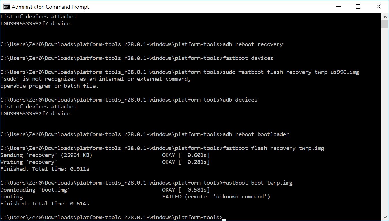

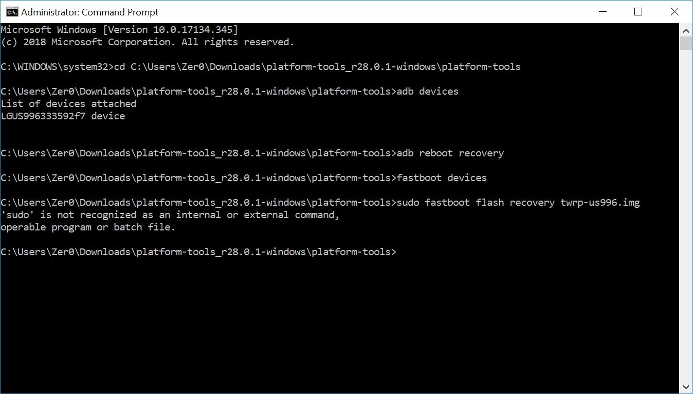

Now that I actually have some time off of work, I'm trying your directions there. I get to the part where it's asking to boot from the image, but I get the following error...View attachment 136987
You stuck a hyphen in the last command. Best to just copy/paste what I wrote.
EDIT: Actually the last 2.
EDIT2 - My bad. Filename appears correct. Back to the drawing board...

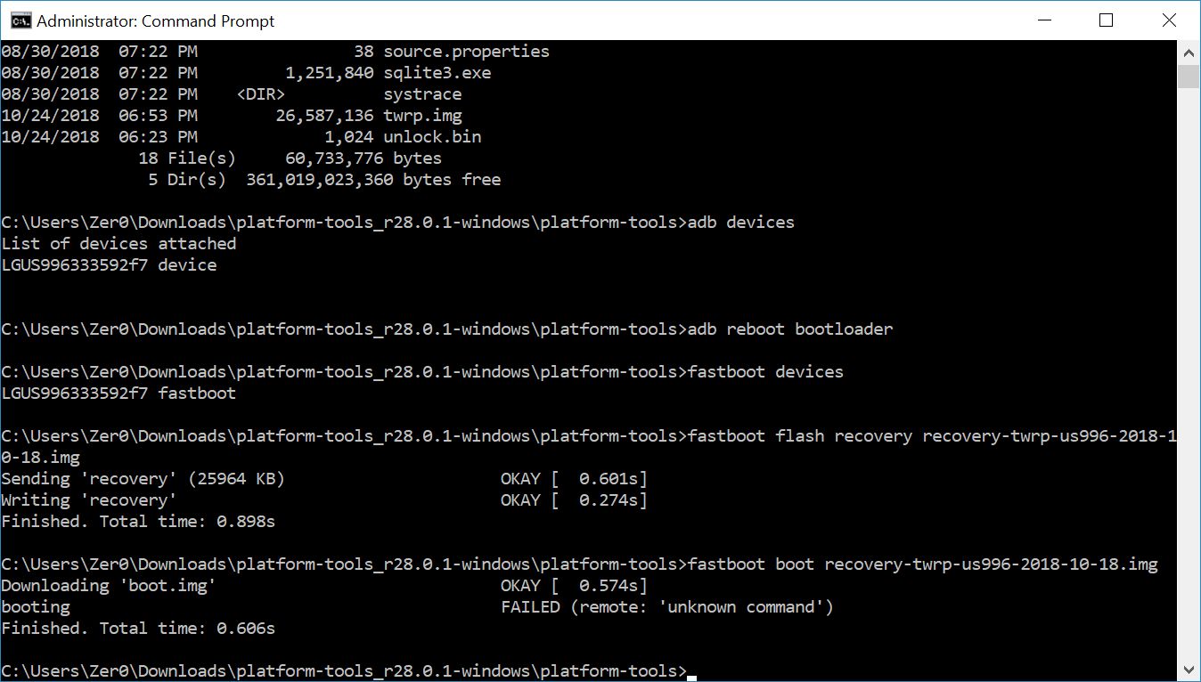

That's the name of the file, though, as it arrives from the XDA link. the twrp site insists they have no such file for the v20 as it is.
Tried renaming the file to just twrp.img, and then I get this:

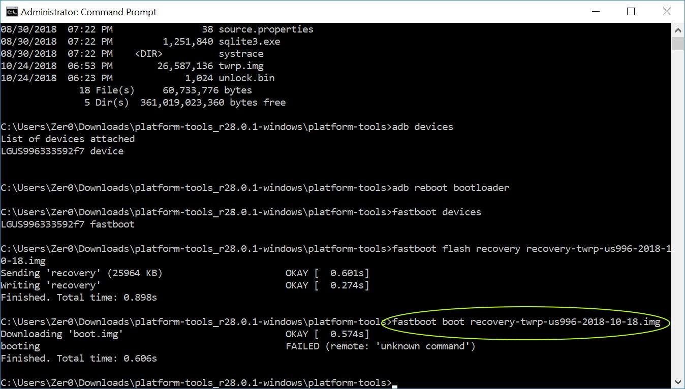

OK. I *think I found it (damn brain farts). Try:
fastboot boot recovery recovery-twrp-us996-2018-10-18.img
Pretty sure I missed an argument:
fastboot boot recovery <image-name>
EDIT: Nope, that ain't necessary. Should be the former. If I don't fall asleep after dinner, I'll regroup - sorry...
Ok, I got up to have a smoke and decided to plug in the actual phone. Note than I'm on Linux, but adb and fastboot terminal screens are the same regardless of native OS. I did try to boot the image:
fastboot boot <my-image-name> and encountered security error, so I decided to actually flash it:
fastboot flash <my-image-name> and it downloaded successfully.
