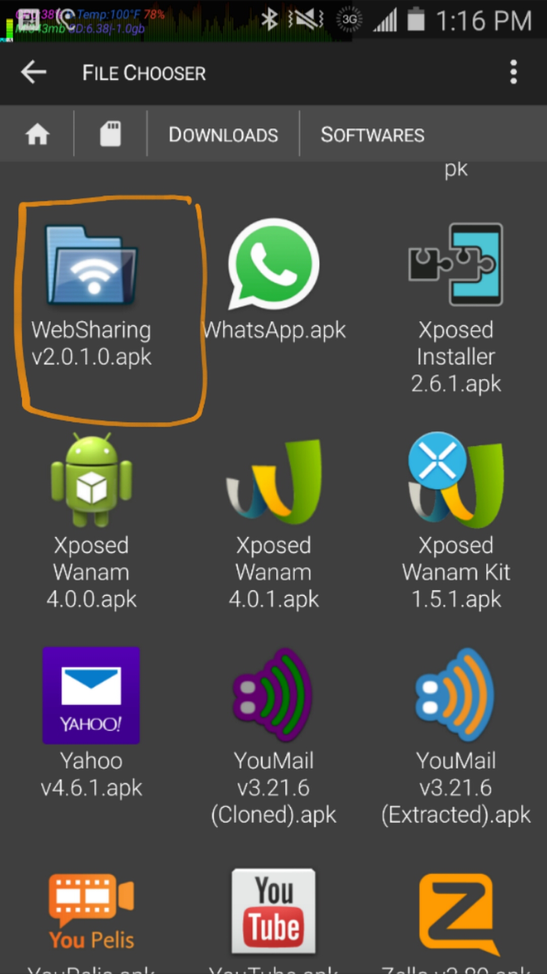

Also about the data transferring over the network(since is your main issue)..there's an app that do that, why don't you try it..
