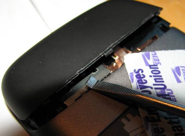

Anyhow image 1 shows how I jammed an old creditcard that was sharpened flat under the metal backing. This allowed me to get a tool underneath the plastic cover.

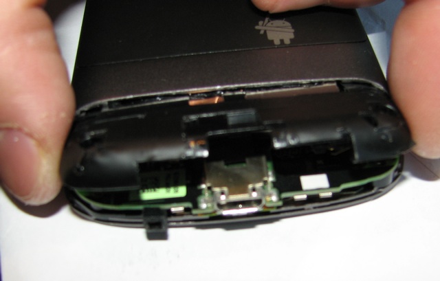

Image 2 shows the bottom cover pried open. If at first you don't succeed, pry pry again.

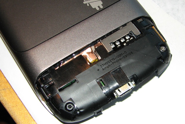

Image 3 shows the bottomless nexus. The torx screw and the philips screw need to be removed.

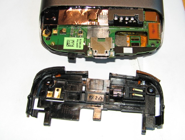

Image 5 shows the bottom section of the nexus splayed open. Note the gold contacts and where they meet. One of the antennas is taped on the plastic frame.

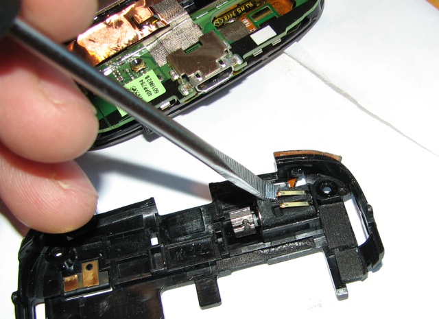

Image 6 shows the vibrating motor. Spin the counterweight in case the motor has seized for some reason (not likely).
Image 7 shows the more likely issue of the flex tabs for the motor not making contact to the pads on the circuitboard. Lightly overflex the tabs so that they will make better contact when re-assembled. You might was well overflex the tabs on the circuitboard for the antenna contact so they have nice pressure when re-assembled.
