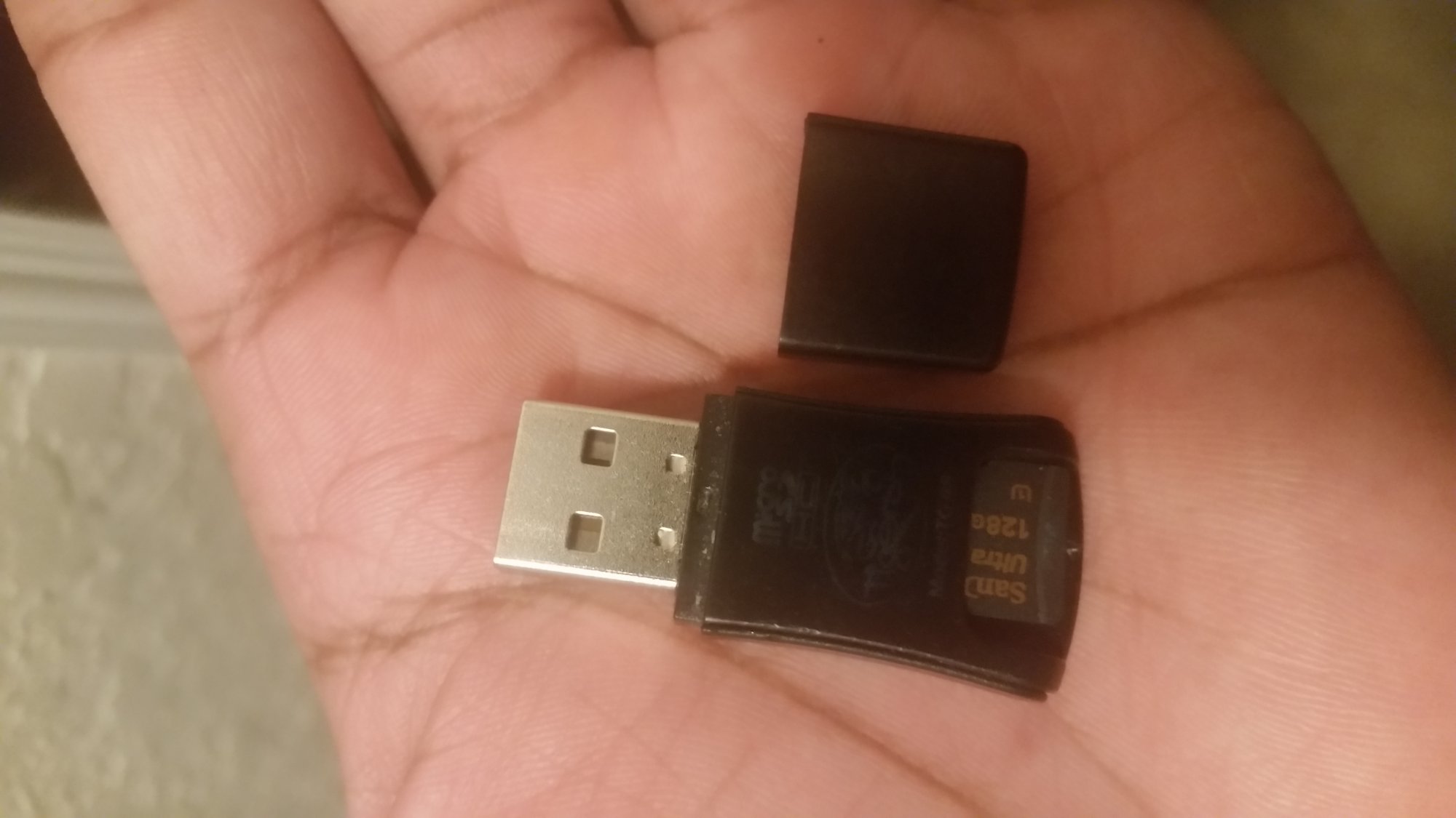

I happen to be familiar with this same issue..
First what you want to do is mount the older sd card on the phone..and go to manage apps..and move one by one any app data that is on the sd card back to internal storage.
Also if you could get a hold on one of these bad boys(exhibits one)..that's the only thing will be recognize on your pc..when everything else you mount with asks you to reformat disk or card or what ever..this particular one doesn't!
I hope it helps as it did to me..

so you're able to access your personal data from the old sd card from your usb reader?
