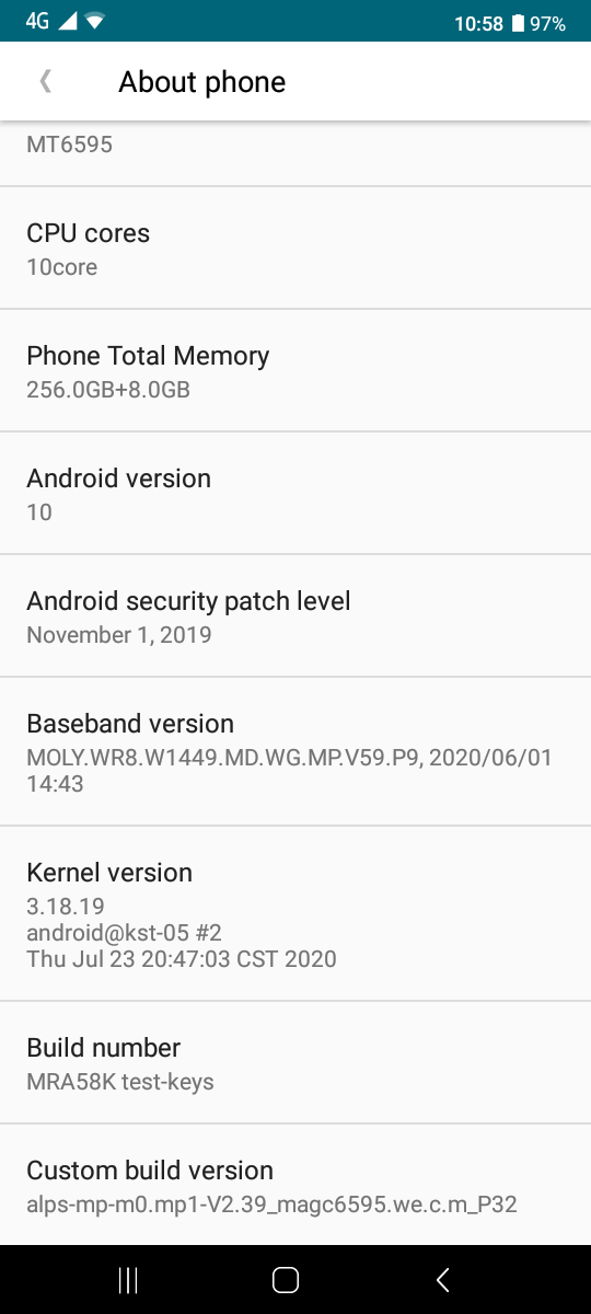

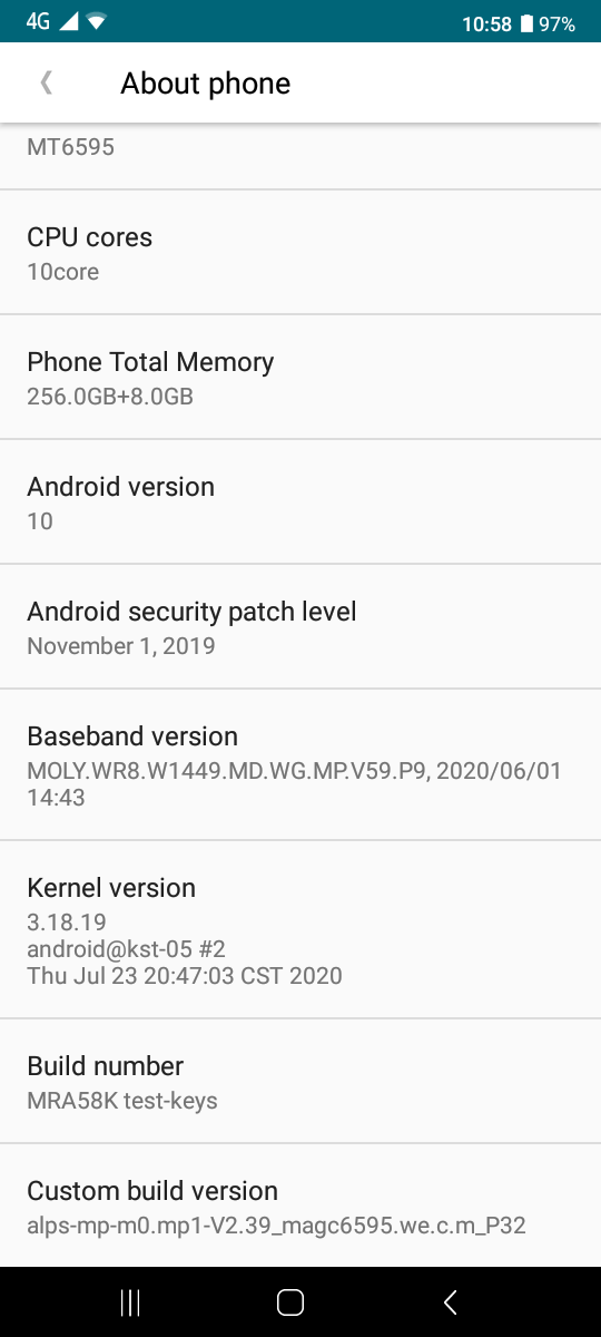

Could you post a screenshot of the system information. Particularly the "baseband version": fakes are usually programmed to lie about what type of device they are, what software build they are running, etc, but the baseband (radio firmware) is often a giveaway. An unusually good one might show a genuine Samsung baseband version, but if it shows something else (e.g. a MediaTek baseband) then that would show that it was a fake.

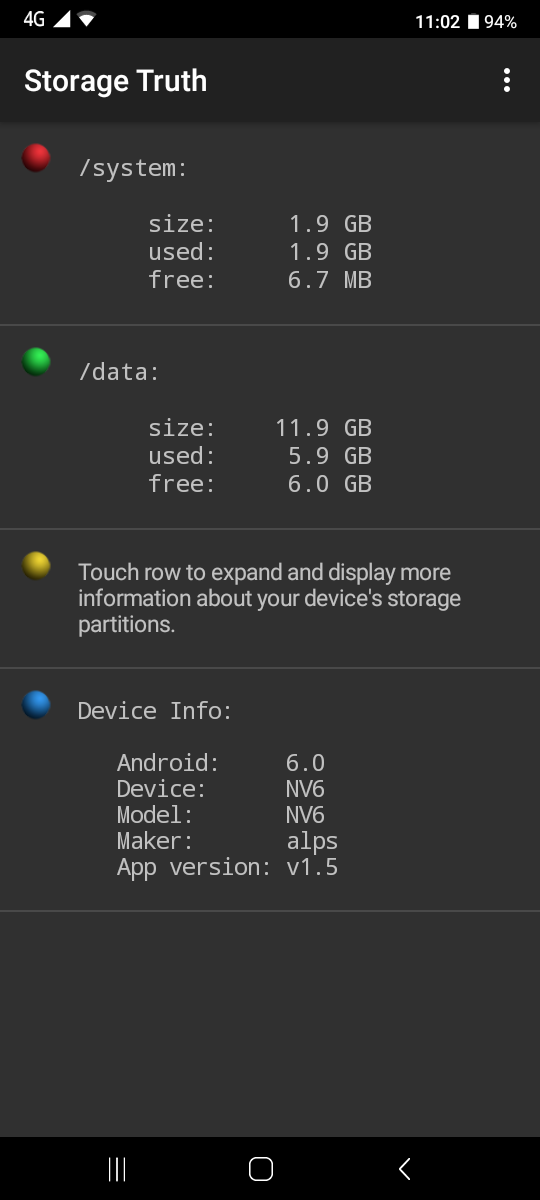

I have attached a screenshot of the system information and of the report from the tool suggested by Unforgiven. The tool does that it doesn't have 256Gb.

Yeah, sorry, definitely a fake, and a low-end device even by the standard of fakes: 16GB storage (which is what I feared when you said problems started at 12GB), a MediaTek MT6595 SoC (an ancient and low-powered processor), and running Android 6 (trust Storage Truth on this, not what the fake system menu says). Probably the screen is lower resolution than it should be, the camera will certainly be low specs, etc.
