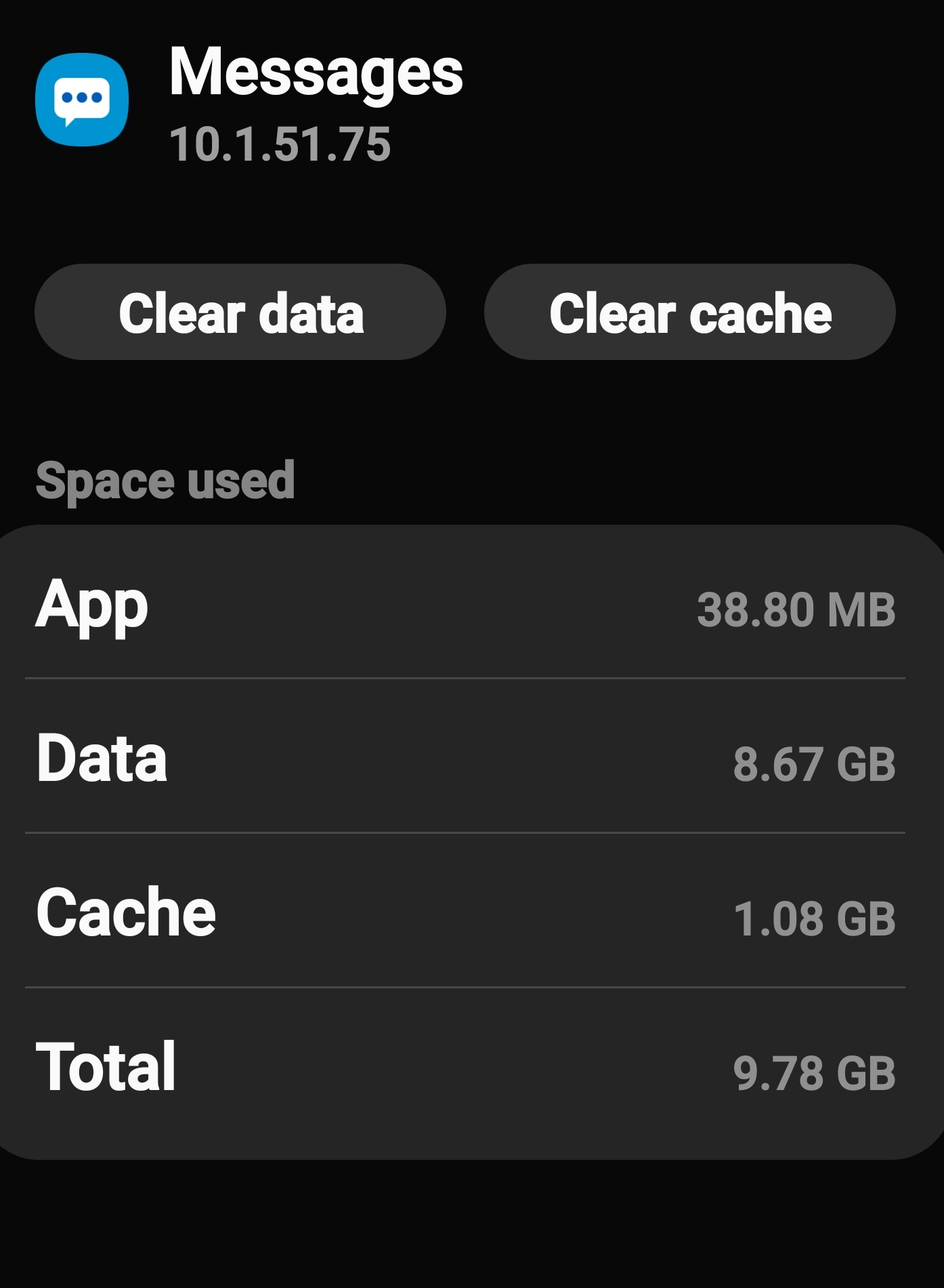

@ Hadron ------ Here is the app screen that I see. The messaging app is circled in RED. I'm really clueless to what app this is officially called. I'm also not sure if its this app that eating up my storage! I can only assume it is because it shows 9.7 gigs.
In the past I have looked at the internal card on my computer and somewhere I saw all the pictures in a spot like data but it took so long to manually delete these photos. If I can find that area again that would be helpful.
That's Samsung's "Messages" SMS/MMS/RCS messaging app. It might be worth clicking on it to see how much of that storage is "cache" (temporary files that can be deleted safely) and how much is stored data.
Unfortunately I don't know how it is using 9.7 GB. SMS and MMS are stored by a different app, so it shouldn't be those unless Samsung do something unbelievably wasteful and store their own copy of every message in that app's own databases in addition (which would double the space needed for the messages). The other uncertainty is RCS (which Google call "Chat"): that app can use RCS, but as I have never used RCS Chat I don't know where those messages are stored (i.e. whether they are stored in that app's data). The reason this may matter is that most message backup apps can't back up RCS Chat messages, which means that if I did use it I'd be careful about clearing any data before I knew I had a backup of those messages. I don't know whether Samsung's "Smart Switch" can back up those (or whether Samsung provide a way of viewing backed-up messages on a computer). Maybe someone who uses that program will know?
In any event it certainly looks like that app is storing message itself, whether those are the only copy of RCS Chats or duplicate local copies of SMS and MMS. Unfortunately that doesn't really help, since the only way to reduce that usage is likely to be deleting messages (unless by some chance there's 6GB of cache in there, in which case you can easily make some space by clearing it).

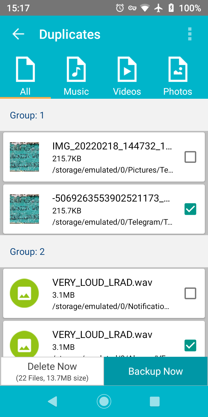

I do not regularly recommend cleaning apps, but there are two that I do (and use myself) for multiple reasons.
The one to try first is an older version that has no ads.
https://systweak-android-cleaner.en.uptodown.com/android/download/1633705
Once it is installed and the permissions granted, check out the Duplicates section first.
This will scan the device and SD card for copies of files, and tell you where they are.
If there are only a few here, then great!
If there are a lot, don't delete them yet.

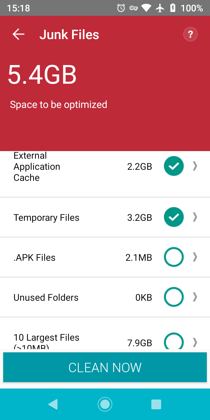

Go back to the menu screen, and select Junk Files.
It may take a minute or two, but this will find, sort, and show the location of files on the device that are generally trash, like thumbnails.
Notice that there are checkmarks, denoting what is to be deleted.
You may uncheck, or tap the item to open it.
Once opened, you may uncheck or check individual files.
You can also tap individual files to see them.
Sometimes I get errors doing this, because some files are not able to be read by my default media app.
Once you make your selections, go back and select Clean Now.
You will be asked to verify.
If thumbnails are a large issue (notice how I have almost 1GB of these stupid things!), then there are ways to be rid of them.
But first, try this app to see if we can locate a large amount of files somewhere and pinpoint the location.
@Hadron This is a screen shot for you. Again I do not want to delete these messages because I've never saved them.
Cache is always safe to delete.
It usually is safe to delete data on an SMS app because messages are stored by another app. But as I say I don't know about RCS Chat, which this app can also do. But if this app is wasting space keeping its own copy of SMS/MMS then presumably if you cleared its data it would just copy them all back, so it would probably be a waste of effort.
So my guess is that the fact that SMS/MMS messages are stored by a separate system app is irrelevant, and to reduce space here you will need to delete some messages. Hence trying to find a backup tool that will let you view messages on another device sounds like what's needed.
