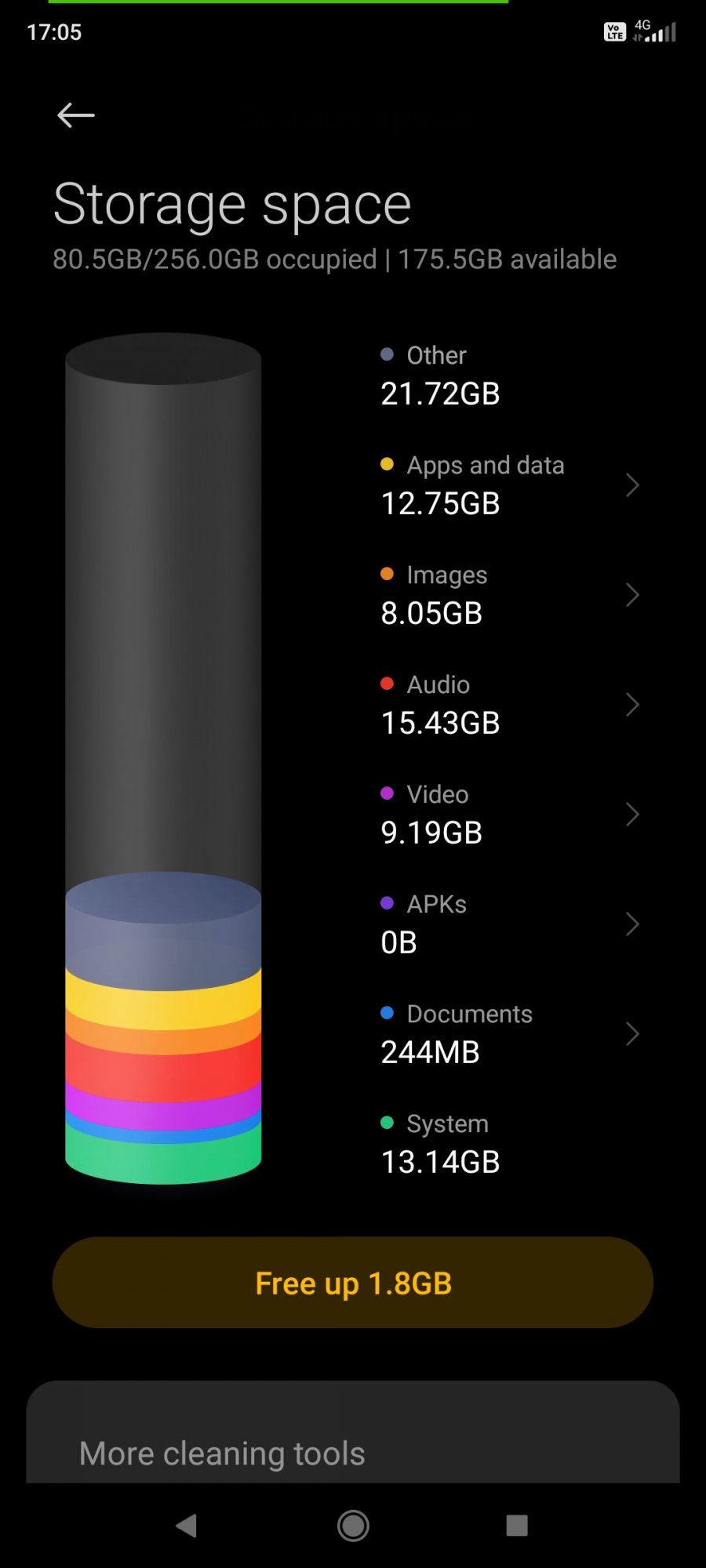

I had a finger in this pie as well, as Xiaomi"s MIUI has Other and I didn't think mine had got so big.

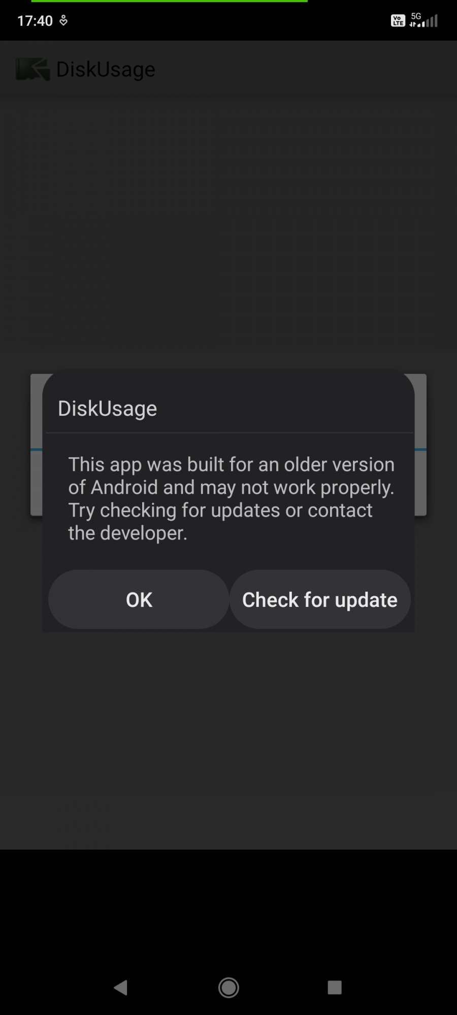

FYI Disk Usage hasn't been updated since 2017 and doesn't work at all. Shame.
I'll get around to solving my 21gb of Other storage eventually, but I have a 256gb model.
Screenshot_2021-12-22-17-05-51-497_com.miui.securitycenter.jpg Screenshot_2021-12-22-17-04-16-518_com.google.android.diskusage.jpg
View attachment 160575 View attachment 160576

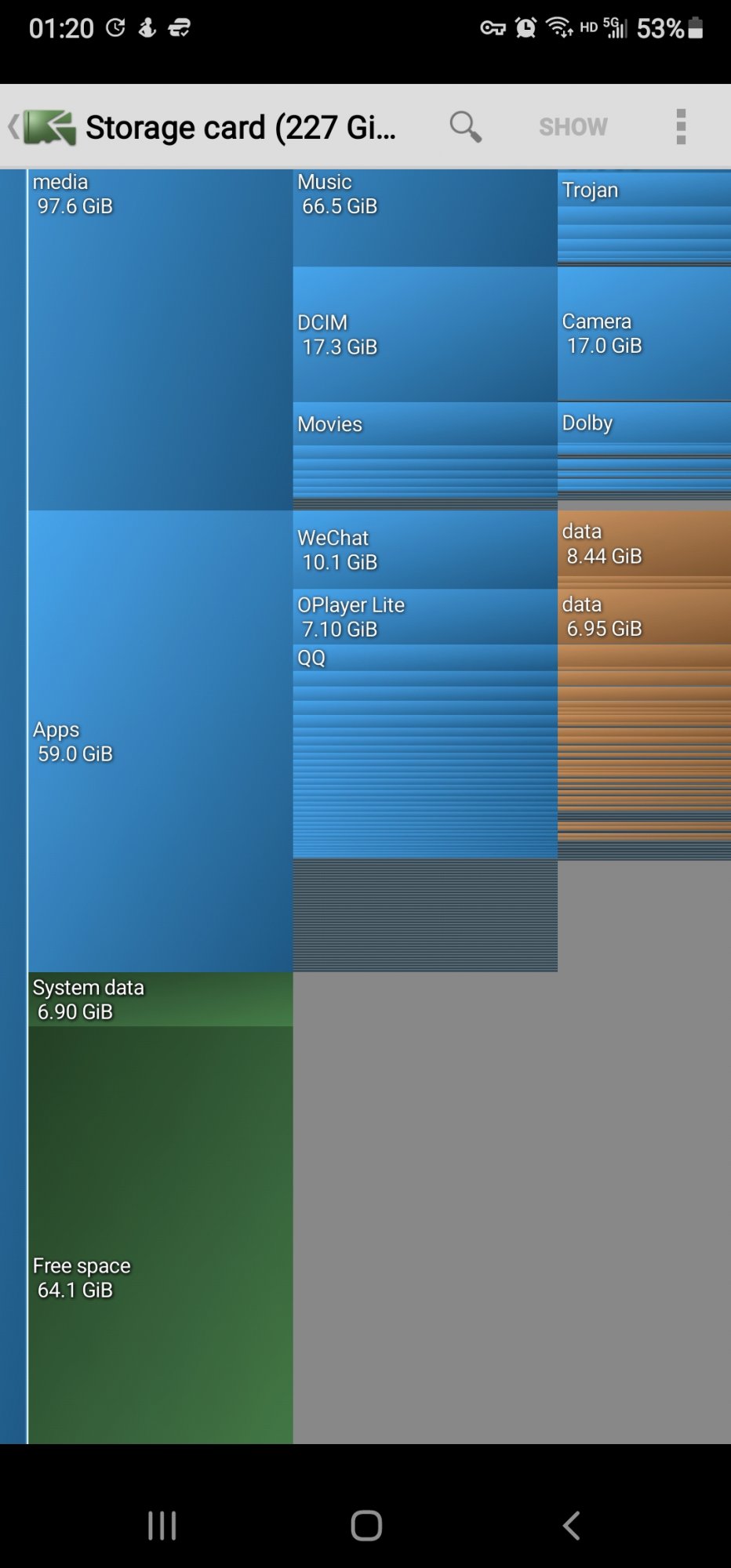

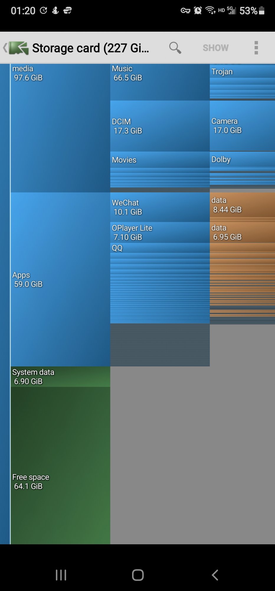

FYI the Disk Usage app works no problems on my Galaxy Note20 Ultra with Android 11. So I think it should run on a Galaxy S10e as well.
Disk Usage shows that WeChat is consuming 10.1 GiB of storage on my phone, which Samsung counts as the rather useless "OTHER".

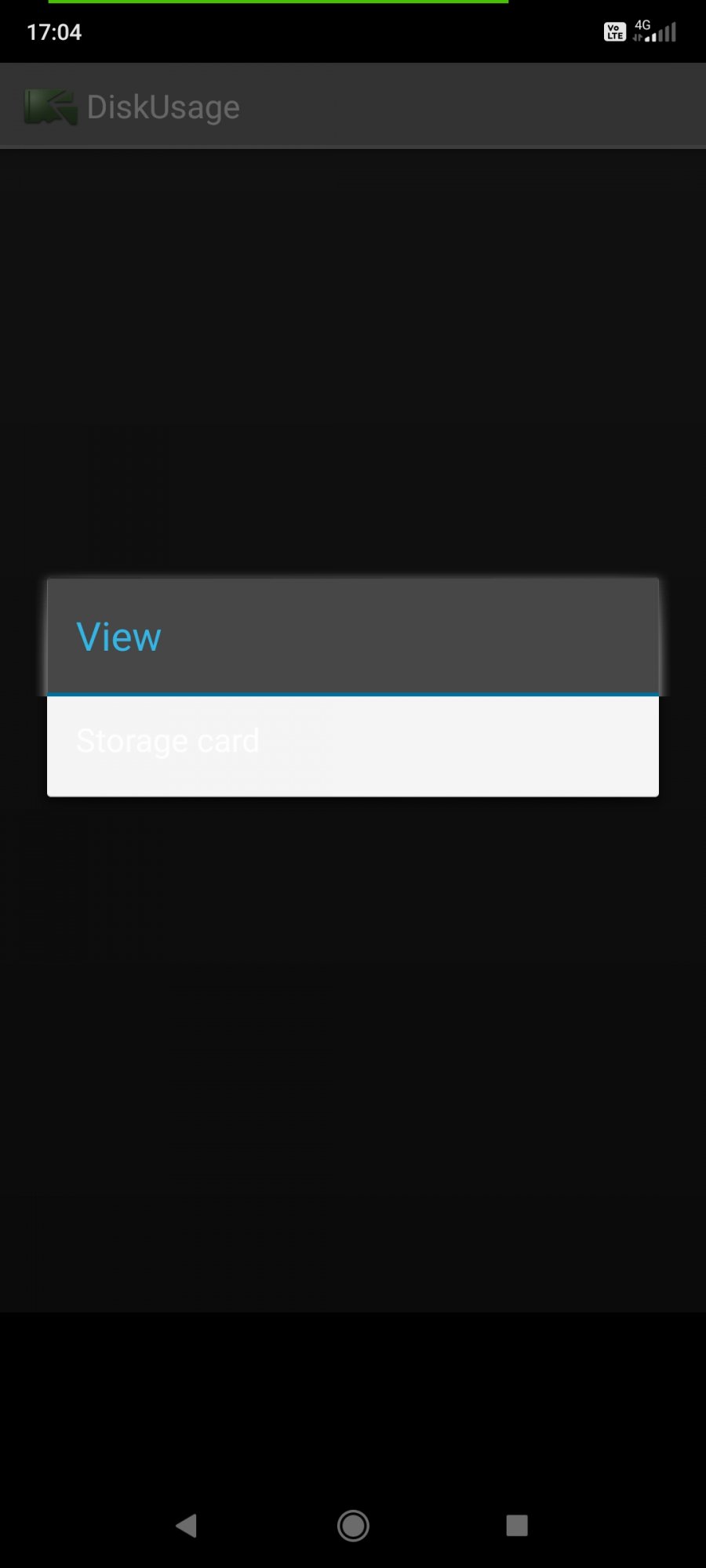

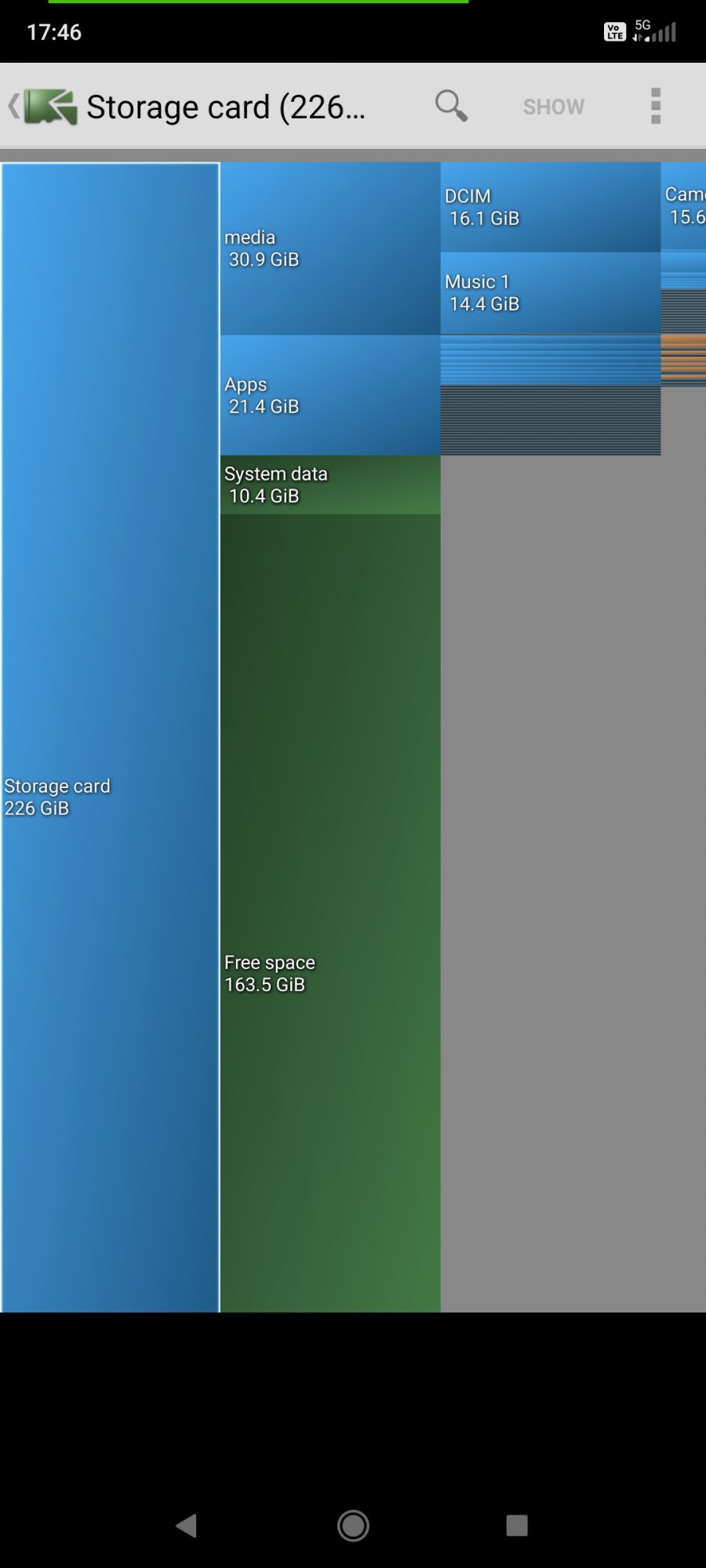

Thanks. You're right. That looked familiar and I have it on other phones, so I tried again. It had seemed unresponsive. I still got the warning on install, but managed to allow permissions and it's OK.
Like yours, my Storage card is showing as 226gb total and that may account for my Other storage as a quick tally shows the rest adds up. I vaguely remember why it might show 226gb instead of 256 in the way Gb are read perhaps.
I'll look at it again later. :rolleyes::cool:
Screenshot_2021-12-22-17-46-11-193_com.google.android.diskusage.jpg Screenshot_2021-12-22-17-40-54-162_com.google.android.diskusage.jpg
