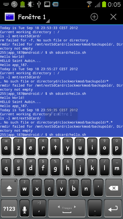

Here is my script:
#!/bin/bash
# My first script
echo "Hello World!"
echo "HELLO Saint Aubin..."
echo "Hello $USER."
echo "Today is $(date)"
echo "Current working directory : $(pwd)"
rm -r /mnt/extSdCard/clockworkmod/backupold/*
rmdir /mnt/extSdCard/clockworkmod/backupold/
exit
Screenshot is enclosed.
I tried a lot of of things, but mainly I wrote the script under UtraEdit in W7, wrote to the phone, enabled this script called "hello.sh" with chmod 755...
Nothing worked, I even don't understand what happened, because the warning (when issued) are inconsistent. Finally, I found that I can list variables, it works and send message on the terminal. But as soon as I put an action statement like RM or RMDIR it doesn't work and mainly I don't have any track to make the problem determination.
Perhaps I don't know enough (I am a beginner with Android) and made a big mistake or missing someting. But look at the screen, on the rm for emptying the 'backupold' folder, it answers 'no such file or directory', but after that on the rmdir it says 'directory not empty'. If I use the terminal to enter these commands (excep -r in the rm that I didn't test), all work OK.
I really don't understand.

Don't create scripts in windows. Just create a text file on your phone.
Start simple. Create exactly same as me then get that working. Then next step
There are lots of things going on that are tripping you up.
  • /mnt/extSdCard is mounted with a setting that tells the OS to ignore execution of programs/scripts. Therefore, adding execution permission (chmod 755 ...) will not work. You will need to run the script by executing the shell interpreter (/system/bin/sh) with the name of the script as the argument. Hence, my example of executing your script via: "sh /full/path/to/your/script"
  • Android runs everything using separate user accounts. Android also has separate ownerships and permissions set for each directory. In your screenshot, the user "app_187" is used to execute all your commands. It might be that "app_187" does not have the permission to remove files/directories from the /mnt/extSdCard/clockworkmod directory. This was why I suggested you use the "su" program to execute your script with superuser credentials (i.e. su -c 'sh /full/path/to/your/script').
  • Android's Korn Shell equivalent (mksh) wants end-of-line (EOL) markers to be <NL> (like most UNIX-based systems) not <CR><NL> (all Windows systems). You will need to force UltraEdit to strip off the <CR> and only use <NL> as the EOL. If you forget and leave the EOL windows-style, then many of your scripts that rely on IF...THEN...ELSE...FI will fail.

As I stated in my previous post, you need to make sure UltraEdit writes out the script file using UNIX end-of-line markers. I can't tell you how to do that since I don't use UltraEdit.

You are right, I re-edited the file on the S3, deleted all the end-of-line markers and it works like a charm.
