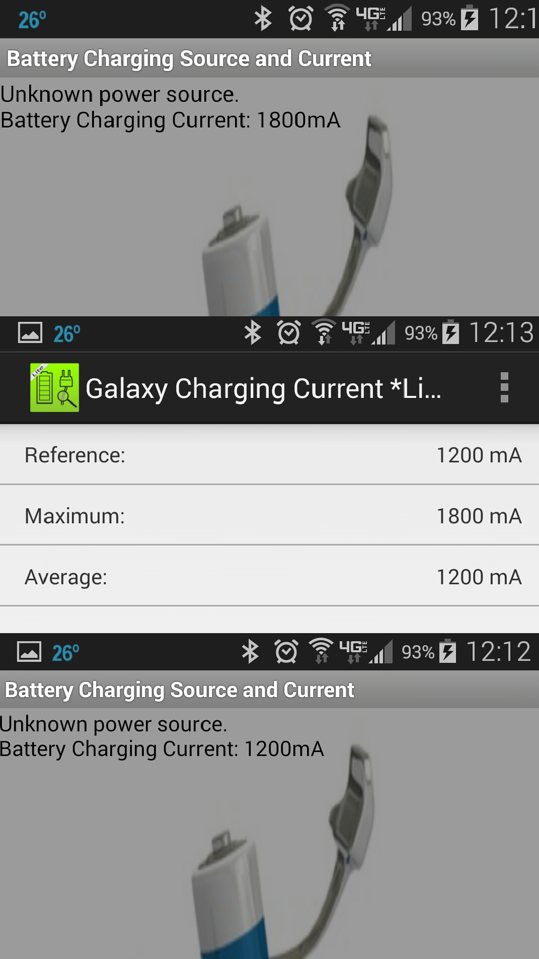

Great info guys. I have been using a simple app that appears to do a pretty good job at helping me sort out my old cables and chargers. It can tell you what your battery charging current is when you have your phone plugged in: "Battery Charging Source and Current" https://play.google.com/store/apps/details?id=com.promethyl.batterychargingsourcecurrent&hl=en.
(Disclosure: I have NO financial or non-financial relationship with the app developer FYI). Nothing elegant about the app but it does appear to work on my phone and it's free. I agree with AZgl1500 on all points- that it does not matter if you use the micro USB or the USB 3.0 but that you want to be mindful of the output of older USB AC adapters. My s5 seems to charge usually at 1200 mA most of the time but I believe it also might also sometimes charge at 1800 mA with the OEM charger or other chargers greater than or equal to 2.1 mA via micro USB or USB 3.0 (doesn't seem to matter) WHEN the screen is off. I noticed that when I run the meter app, it reads 1800 mA when I first turn the screen on and check, then it refreshes to 1200 mA. Does anyone know if this is true? I also agree that my older USB AC adapters with lower outputs do limit the charging current- I've seen 750 mA and 1000 mA from some of my older chargers- specifically it seems to be limited by the output mA of the USB AC adapter. To my knowledge, the lower charging currents just make for a slower charge and are not harmful. I haven't gone through my stack of old micro USB cables to see if the cables themselves vary in the charge that they provide.

yes, I have used that same charging rate app and noticed the "Peak" charge rate at 1800 or 1200 but it always seems to drop back to 750 mA on my Qi chargers.
