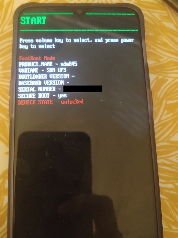

Okay, so I've read through the instructions a couple of times. A couple of questions:
1.) Are you sure you didn't already install the recovery?
I see in the image you posted that you are on the bootloader screen. If you use the volume keys from there to navigate to "recovery" at the top of the screen (power button to select) does it take you into a custom recovery or the stock recovery?
2.) Did you get any errors when flashing the recovery file?
It sounds like in some cases you may have to manually flash to boot_a. It wouldn't hurt anything to try this anyway. I believe the command would look like: fastboot flash boot_a filename.img
You could also do the same for boot_b
3.) Wow, I just realized that you uploaded a copy of your command prompt text. I missed that yesterday. Thanks! That is helpful in seeing what happened. The instructions are a little unclear on the sideload. I believe even the stock recovery has a sideload option built into it. I wonder if you are supposed to be choosing sideload from the custom recovery?
This right here sounds like an option in the custom recovery to me (unless it's an option in the bootloader while using the volume keys). Where did you find this option to select update and then update from adb?

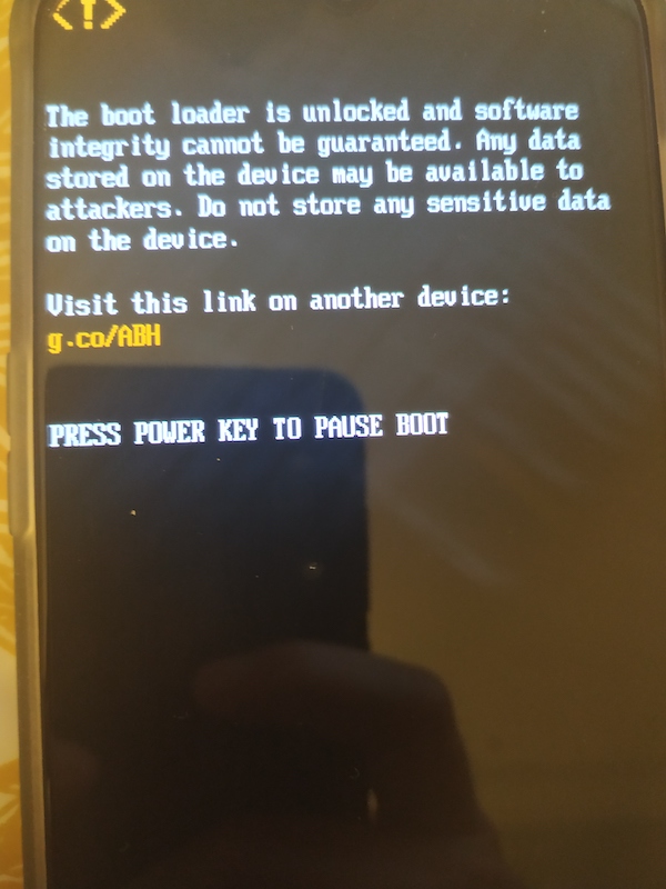

That is, I get the infamous 'The boot loader is unlocked and software integrity cannot be guaranteed ...etc' when powering on with just the volume key down
That is just a standard warning because the bootloader is unlocked. You will probably see that any time you boot the phone up. It's just there to let you know the device has been tampered with.
step 5 didn't power the device off for me, so I assumed they meant that one should power the device off first and power it on again in the way they describe, which I did.
Correct, this command wouldn't shut down the device. When finished running you should still just be in fastboot mode as before. The instructions seem like they were probably copy/pasted and pieced together from the instructions for other devices.

Okay, so when you select recovery and you see that screen, are you always pressing the power button (which stops the phone from booting) or have you sat and waited to see if the recovery boots up after that screen and without pausing the boot sequence?
This doesn't sound like a boot loop to me. A bootloop is generally where the device gets stuck in some part of the booting sequence then restarts and does the whole thing over again (a loop). It sounds like you may just be pausing the boot sequence. You do seem thorough though, so I'd be surprised if you hadn't tried without hitting the power button, but it's worth looking at all options.
The plot thickens... before when selecting recovery (after booting into fastboot mode) I had just pushed the power button and let go. Then, as you say, waited for it to boot (I thought it might eventually boot owing to the message but it never did). Just now, I thought I'd try the opposite. I selected recovery mode with the power button but held it down a little while. That seems to have resulted in it rebooting and it loads the 1+ symbol in the middle of the screen but nothing else...
It's been like this at least 3 mins now... perhaps I'll just switch it off again (volume up + power button)

@Brian706 perhaps I should clarify I mean that I used the up/down keys to select recovery mode then just pressed the power key once, which restarted the device and I saw the same screen. When I did the same just now and held down the power key a bit longer it just showed the 1+ icon for several minutes (and 'powered by android' at the bottom), so I reckon when I hold down power it does indeed pause the boot and that is what is shows me.
Sorry I should say I see the 'integrity' screen, not the fastboot screen when I pressed once to select recovery.

@Brian706 finally got around to picking this up again. Spoiler is that I ended up flashing the stock oxygen ROM again. Not done much testing but so far seems to be behaving fully. I thought I'd let you know as you took so much trouble the other day.
That said, I'm going to regroup and go looking for trouble again as I literally bought the phone to investigate alternatives to stock ROMs. This time I guess I'll try using TWRP as I've seen many people say that often works where the 'official' recovery images fail.
FWIW, I did try to flash twrp from where we left off but I just got some message about FAILED (remote: Failed to load/authenticate boot image: Load Error). Few other people had the issue but there wasn't much info about how to fix, especially for the 6T specifically. I was trying from those instructions rather than the ones on the official TWRP page for the 6T because that official page suggested it couldn't be done with the official TWRP unless TWRP was already on the phone or you had a special cable. I was hoping the unofficial version (by the same maintainer as the official one!) would do it but no luck.
So I found this post about installing the stock ROM by the same, guy (mauronofrio) - seems a sort of android super hero. It worked (though I left a couple of notes toward the bottom of the post as I found some minor roadblocks in using).
Will drop another note if I finally get lineageOS or other working via TWRP recovery and I'll install TWRP before beginning.
