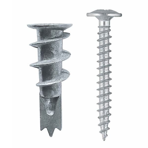

Never secure ANYTHING to drywall alone.
I care less about whatever device, or whatever the packaging for said device says.
Drywall is barely capable of holding itself to the wall when properly hung, and that is ALL that it is designed to do.
ANYTHING else is like a bandaid on a sucking chest wound and only asking for aggrevation and holes in the wall.
Mount things to the same studs that the drywall is mounted to.
If there are no studs behind the drywall where you need them to be, then you should put some there.

I had to put some drapes up on plasterboard/drywall once. I fixed a wooden batten securely screwed into the studding, and then fixed the curtain rail to the batten.
When I was an line-engineer for British Telecom, we often had to fix telephone sockets to plasterboard, which are lightweight things. But we used proper plasterboard fixing plugs and screws...
I have used those things, and even the winged things you fold together, push through, (the wings expand then) and tighten the screw.
They will work, but they are temporary at best.
And very weak, as the drywall must first be damaged to use any of them.
They then expand and/or clamp into/behind the drywall that has been weakend with a hole.
Going into the studs is the only proper and reliable way.
