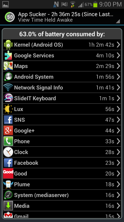

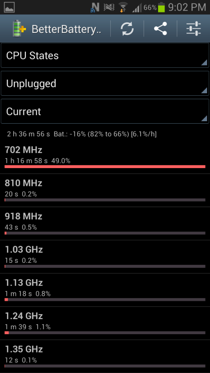

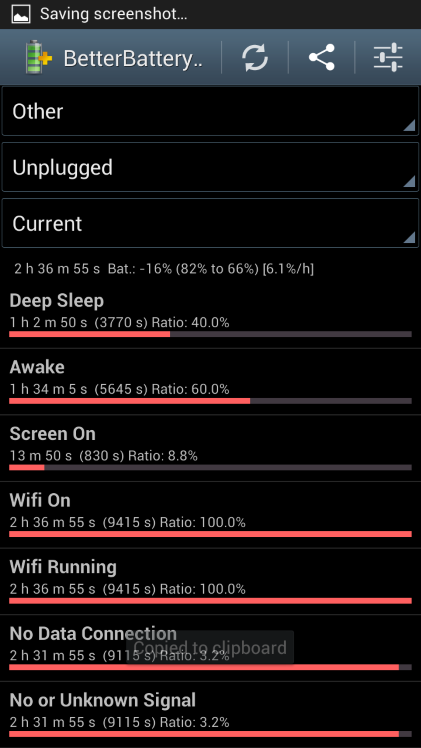

Over the last month or so my battery has been draining at a very high pace. It used to drain at about 1-2% per hour when the phone was not in use. I have GSam and Better Battery Stats and have been doing some investigating but I can't seem to nail down the cause. It seems that the phone is staying awake for about 50% of the time it's not in use which is likely what's contributing to the drain. The problem is that GSam and BBS show that it's Kernel (Android OS) that's keeping it awake which isn't very helpful. I've attached some screenshots with some observations below. The stats are for approx. 2.5 hour period.
  1. Battery drained by 15% total (6% per hour)
  2. Screen is only on for total of 14 minutes
  3. Screen is dark for 13 minutes and dim for 1 minute (so not very bright)
  4. Phone sleeps for only 1 hour
  5. Phone is awake for 1.5 hours
  6. Kernel (Android OS) keeps phone awake for 1 hour
  7. wlan_rx_wake is 1 hour (which matches Kernel (Android OS) wake time)
  8. CPU is at 702 MHz for 1.25 hours (despite screen off and phone not in use)
Does anyone have any ideas on what's going on and how I can resolve it? I've tried a whack of stuff like turning off location sharing, removing apps that might sync that I don't use, changing sync settings, etc. I can't figure out what the problem is and it's driving me crazy!
Thanks!
Thanks!
Have you run a scan for malware or spyware?
Do you recognize all of the systems or apps that keep your phone awake? You should try asking Google what each one does. A lot of times tracker apps will disguise themselves as system requirements. Anyway I seem to have had a similar problem and somebody was syncing my phone using the logger. I know some things to look for our SMS tracker, dailymotion, I might be in your best interest to look into what types of apps people use for tracking and how they appear in the applications menu.
Just download a wake lock detector and let your phone sit for a while and you will see what apps are waking your phone and how long....
